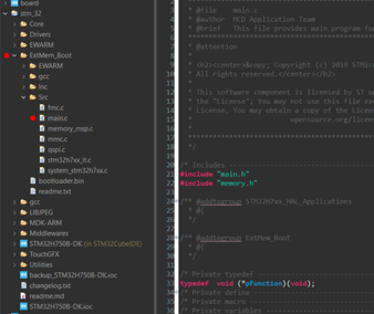

When a new project is being created using Touch GFX, the project folder contains a sub-folder ExtMeM_Boot. This folder contains the source files and includes of the bootloader and its dependencies. A pre-built binary is also included (bootloader.bin) which is called by the linker script. The board that I'm using is a STM32H750 Dev - Kit.
My requirement is I need to perform some modifications to the bootloader program (main.c) and rebuild it to generate binary. Is there a method to build the bootloader program simultaneously with the main application or should I move all the contents and its dependencies to new project or is there any other standard method.

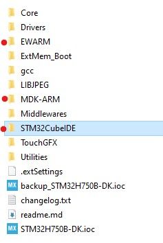

Yes, you can easily apply your modification to the main.c file and generate the project. You just need to open the STM32CubeIDE project that is available at the folder with the same name which is created by TouchGFX. You can also open the main project in Keil μVision or IAR Embedded Workbench.
Available projectsAvailable projects
STM32CubeIDE projectSTM32CubeIDE project
I hope this helps you, don't hesitate to ask more questions

Thank you for your reply, I actually want to build the bootloader program which is located in the ExtMem_Boot, while being the in the same project. I attached an image below.
You may have answered it already, I have some trouble understanding it.

In the below image i have marked the "main.c" of the bootloader. The same open project contains the application main file as well which is the file usually  built and programed. A pre complied binary of the bootloader is already given, but I want to  rebuild the bootloader program and generate the new binary file

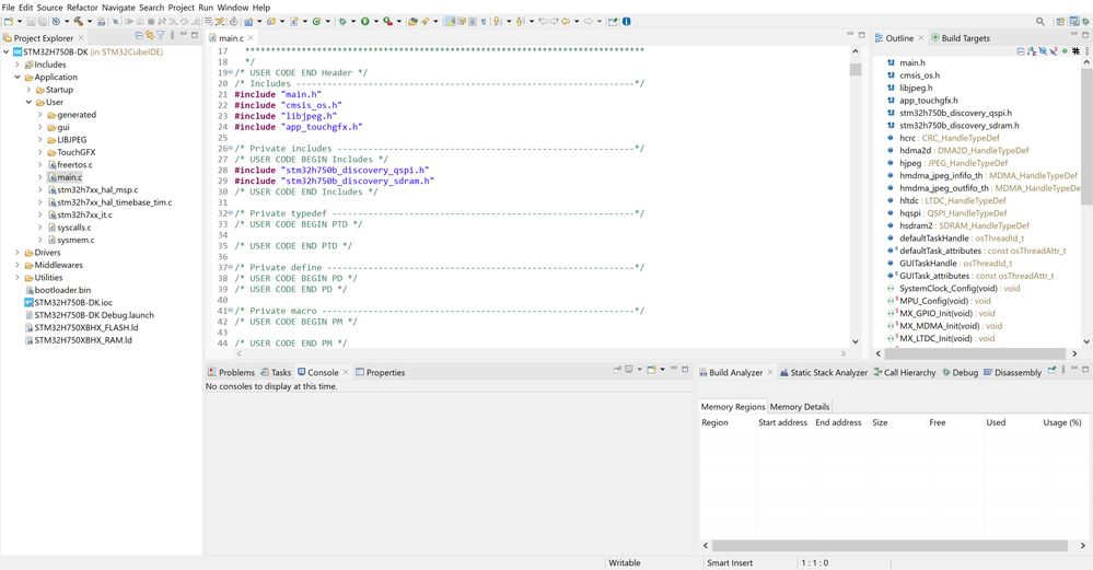

Bootloaders are usually handled as separate projects from the application. If you have the IAR Embedded Workbench, then there is already a project ready to be worked on. If you don't have IAR, then you need to create an STM32CubeIDE project and add the files in the gccInc and Src folders and then use the Makefile to generate the .bin file.
I don't think you can develop both Bootloader and Application under one project, at least I don't know about it.
