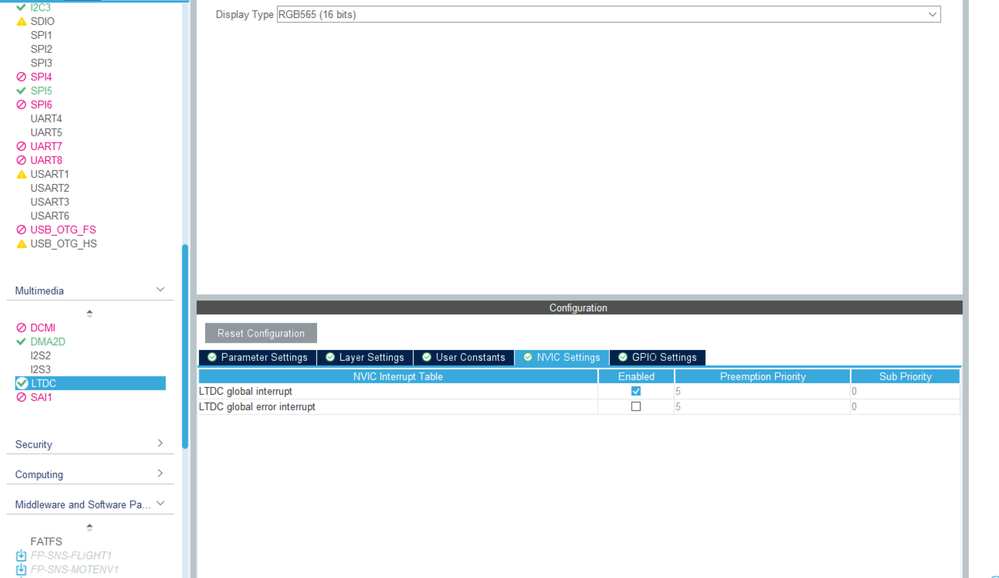

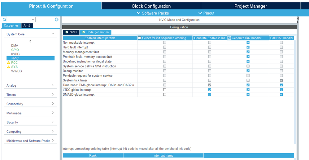

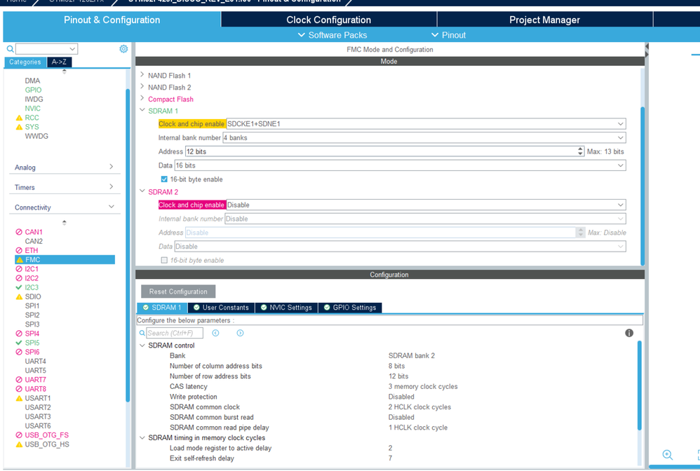

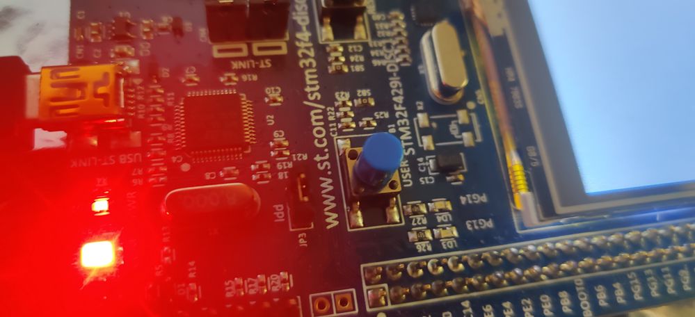

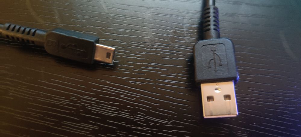

Hello @HectorV,
There are several points to check:
Make sure that you are using USB cables for communicate data (not just for charging).
Check Idd jumper. Check DRAM initialization/configuration.
Have you enabled LTDC global interrupt and IRQ?
Imen.
HectorVAuthor
September 26, 2023
Thank you for the reply. I am new to STM32 so there is still a lot of stuff I don't know about so please bear with me. Here is what I have. I have tried two different usb cables and I get the same white screen. By the way, the demos on touchGFX work on my board. Please let me know if you see anything wrong on my options. I have attached pictures below.
MM..1
September 26, 2023
Your ide steps 1.TGFX 2.CubeMX is as idea ok , but most time dont work. Using MX over TGFX projects corrupt allmost func. I mean after create TGFX your display work and buttons LED ON OFF is showed ok?
HectorVAuthor
September 26, 2023
When I first created the TouchGFX and connected it to my board via the run target button, my project did show on my board. Now when I try to do that the screen is white. I think like you said by using MX it corrupted my project. So how would I be able to do my project? I am trying to create two buttons with TouchGFX, labled LED ON and LED OFF. By pushing LED ON the user led PIN G13 turns on and by pressing LED OFF the user led PIN G13 turns off. How do you recommend I go about this?
