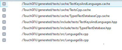

i'm using cubemx and updated from touchgfx 4.21.2 to 4.22.1 and also installed the newest touchgfx designer.
After regeneration of the project certain files like TextKeysAndLanguages.hpp are missing. So all my texts are missing.
i can see it in my git that these files were deleted
Also <fonts/ApplicationFontProvider.hpp> is missing and generates build errors

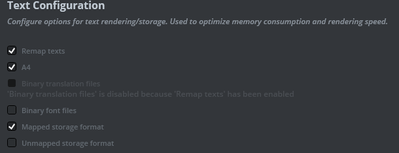

In TouchGFX designer i see all my texts and this is my text config (which i did not change after updating from the last version)
Any idea what might be the error?

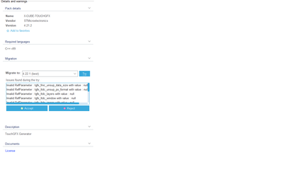

i update touchgfx via cubeMX which gives me some errors(don't know if it is important)
i open my touchgfx project in designer 4.22.1 and regenrate *booom* files are deleted and not regenerated

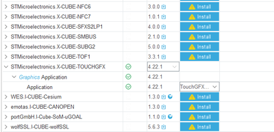

Is it possible to try installing the new version (TouchGFX 4.22.1) manually from CubeMX -> Help -> Manage Embedded Software Packages, then under the STMicroelectronics tab, X-CUBE-TOUCHGFX section ?
After installing, open your project, then go to Software Packs -> Select Components and make sure the version 4.22.1 is selected.

ok, the version was selected. But i did not notice the settings for touchgfx   itself (resolution, pixel mode etc) were not set. After setting these again the files are generated.
