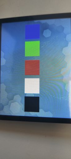

Hello.
I have made a custom project with STM32H735IGT. I use Touchgfx.
I am using external flash and external RAM. The problem is when I place the framebuffer in external RAM. Some green pixels appear as in image 1. When I place the framebuffer in internal RAM, the image is painted well.
I am using IS66WVH16M8DBLL-100B1LI RAM. I attached hardware configuration, the RAM is OCTOSPI2.
video of the problem and .ioc:
Where is the problem?
Best answer by fernandogamax
it seems that it is a signal synchronization problem. I have changed the resistances of the CLK and DQS. For resistances of 120. It seems that the problems have been solved. We have ordered the new 4-layer PCB. When I do tests on the new board, I will write to you.
Thank you very much to all.

Hi @fernandogamax,
Have you tried with lower OCTOSPI Clock frequency? It seems you have already exceeded the max frequency as detailed in datasheet. Could explain the use of the MPU configuration for SRAM region (0x30000000)?

hi, this is not a read/write problem in RAM, if you look at your problem you realize that the green pixels are positioned circularly on a shade of the image, therefore typical of a particular color. I believe that you have some problem on the LTDC transmission line of the display or from the RAM to the micro, and that it concerns the low bits of the line itself. Probably the RAM line since the problem is not found on the LTDC when internal..

mmm if you put the bitmap in the internal flash and you have the same effect, then it's useless to search on the octospi... without the external RAM everything is perfect, then it's the RAM. Very strange over some colors. I think only can be hardware line frequency problem or DMA data corruption.

You have PB8 LTDC_B6 and PB9 LTDC_B7 in fast mode disable in LTDC, why? this is blue region of color, exactly your problem

hi Fernando, I see all documents, checked datasheets... nothing wrong, a little error is place termination resistors at the end of line, but ST make this abomination in his hardware, but this is only a detail, and not corresponding to your problem, I think many have no idea judging by the fact that everyone is watching and no one is responding. Good luck buddy, it would be nice to know what happened when you figure out the problem.

Could be caching issue with external RAM. Yes, you should configure the MPU, but to test if that is the issue at all, disable caching for the whole system. Test. If the colors are still there, it isn't the MPU configuration.

I have placed the screen all Blue. In debugging I have been looking at the external RAM, and I could see the following errors. And they repeat.
Any idea why that could be?

Try direct write to problem place.
*(0x70000000) = 0x....
and better big rectangle write from c code , not from touchgfx render.
