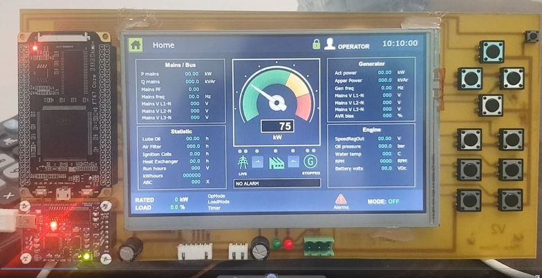

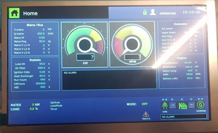

Hi ..

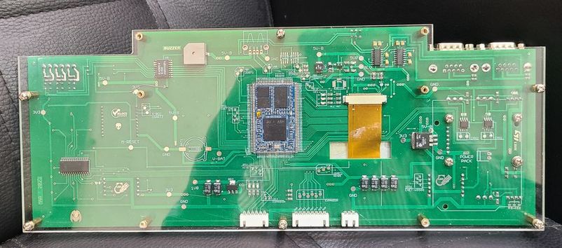

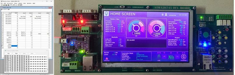

here is my custom designed board with STM32H745XIT6 & 1024X600 TFT with TouchGFX.
INaee1_7-1687542089614.jpegCM4 running Modbus Master RTU
CM7 running TouchGFX with 256MB SDRAM
Here is TouchGFX , running on SAMSUNG TAB3 7.0 ,, 1024x600 , LVDS LCD & TouchGFX (STM32F429i-DISCOVERY + SN75LVDS83B) :
Here is TouchGFX , running on CHINESE 800X480 TFT (DE Mode) & TouchGFX (STM32F767 WILDFIRE BOARD)
Tested Modbus on it with same usb cable coz I developed st-link board with usb hub chip and ft232rl. (Power + SWD + USB232/modbus)

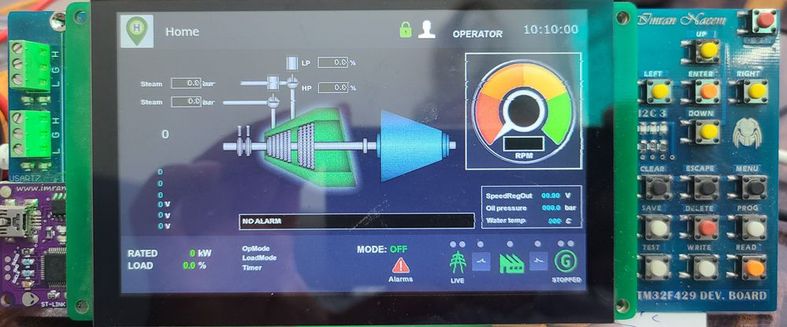

Here is TouchGFX , running on 5.0" ,, 720X1280 ,, RGB + SPI TFT with STM32F429i-DISCOVERY
LCD PART No. TL050HDV31CT5-H1206A
The lcd driver chip/COG is NV3052

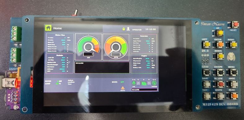

Here is TouchGFX , running on 5.0" ,, 800X480 ,, RGB TFT with STM32F429i-DISCOVERY,

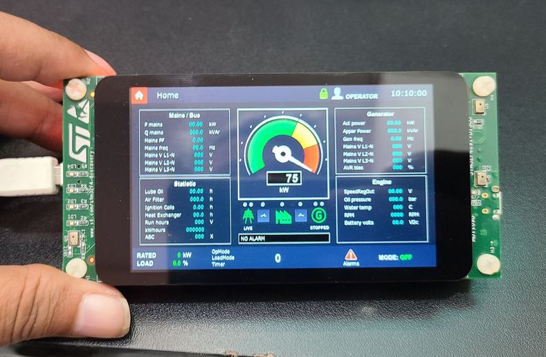

Here is TouchGFX running on STM32F469i-DISCOVERY

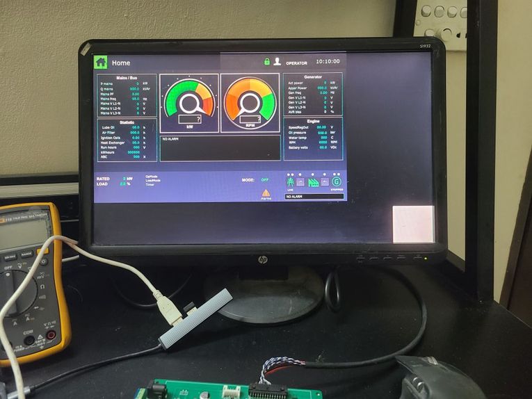

Here is TouchGFX running on HP S1932 18.5" Monitor's LVDS LCD with 1366x768 resolution .
The lcd part no. is LTM185AT04 or Equivalent . The driver is STM32F429i-DISCOVERY + SN75LVDS83B
Tested following lcds.
SAMSUNG TAB3 7.0" , 1024x600 TFT
THINKPAD T400 14.1" , 1280x800 TFT
GENERIC TFT MONITORS , from 14.1" to 18.5" Maximum tested resolution is 1366x768 TFT
