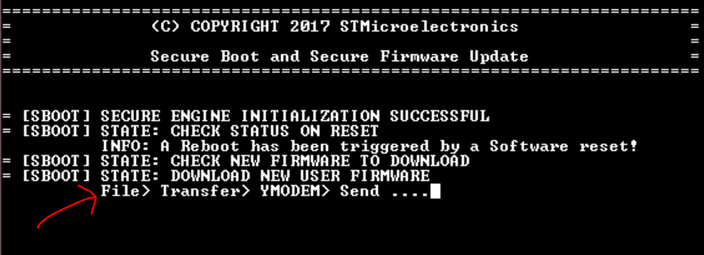

What .c file has the code for the YMODEM portion of the SBSFU pictured below ?0693W00000GW7cAQAT.pngI have found the string "File> Transfer> YMODEM> Send" a few times, but when I changed the string to test if I found the correct area, nothing changes in the picture above.

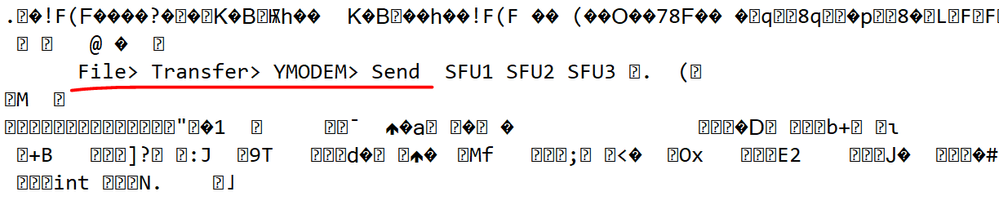

Another tip as to why I don't think I've found the correct code location, is when I have changed the string "File> Transfer> YMODEM> Send" to say "File> Transfer> YMODEM> Send TEST" If I open the SBSFU.elf file the string is unchanged as shown below.

When I open the SBSFU.bin in a Hex editor and swap out the characters "File> Transfer> YMODEM> Send" to "File> Transfer> YDAVEM> Send" Then this is what gets shown after I download the file to the board and run Tera Term. So I guess another way of putting it is, I'm looking for the code that feeds into the SBSFU.bin file, what code is that and what is the YMODEM part of that code?

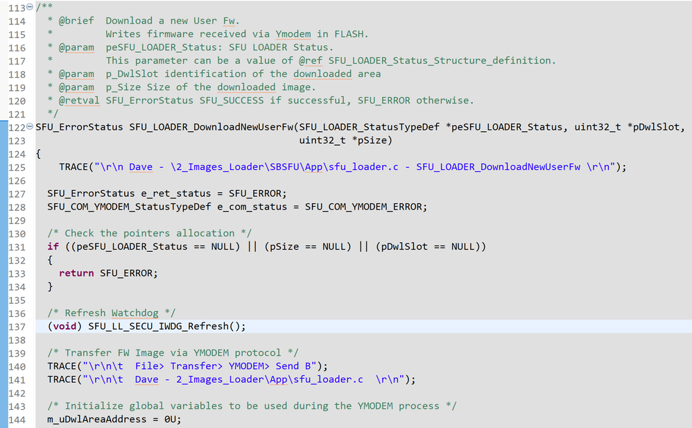

I just took a look at sfu_loader.c around 120, and this is what I see...
I added lines 125 and 141 and added the "b" to the end of line 140. I've never seen those lines show up once I put the SBSFU.bin on the board.
