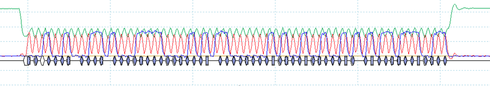

I make a simple test:
CRC32 with polynomial = 0x1EDC6F41, init value = 0x55555555. (no input/output reverse)
I send 4 bytes (0x12, 0x34,0x56,0x78) through SPI communication and on scope I measure what is phisically sent:
Frame: 0001001000110100011110000101011000000101001001001010101101110011
datas = 0x12347856 (00010010001101000111100001010110) --> the second half-word= 0x7856 is sent through little endian convention
CRC32 = 0x0524AB73 (00000101001001001010101101110011)
I can't get the same value (CRC32 = 0x0524AB73) with the algorithm
I use the same algorithm as you: CRCToCheck = Crc32(0x55555555, 0x12347856)
CRCToCheck = 0x27F11ABF ( != 0x0524AB73)
I also tried to fill with empty value 0x00000000 after these 4 Bytes, after 31999 iteration I stop it. CRC is still not equal.
Could you help me to know why the CRC is not good equal to hardware CRC?
Not least because you're using the wrong polynomial, my example isn't using Castagnoli !!
I get 0x524AB730 when the initialization word is ZERO, and the polynomial is correct. Can't really explain the rotation here, but not got much to work with.
Why does it endian switch the last byte pair?
Show the H7 SPI initialization and data transfer code..

I don’t reach the good CRC;
I will share you my source code:
SPI_InitStructure.TransferDirection = LL_SPI_SIMPLEX_TX;
SPI_InitStructure.Mode = LL_SPI_MODE_MASTER;
SPI_InitStructure.BaudRate = LL_SPI_BAUDRATEPRESCALER_DIV4; /* 64 MHZ input clk / 4 */
SPI_InitStructure.BitOrder = LL_SPI_MSB_FIRST;
SPI_InitStructure.ClockPhase = LL_SPI_PHASE_1EDGE;
SPI_InitStructure.ClockPolarity = LL_SPI_POLARITY_LOW;
SPI_InitStructure.CRCCalculation = LL_SPI_CRCCALCULATION_ENABLE;
SPI_InitStructure.CRCPoly = 0x1edc6f41u;
SPI_InitStructure.DataWidth = LL_SPI_DATAWIDTH_8BIT;
LL_SPI_SetCRCWidth(SPI_CH1, LL_SPI_CRC_32BIT);
LL_SPI_SetTxCRCInitPattern(SPI_CH1, LL_SPI_TXCRCINIT_ALL_ZERO_PATTERN); /* enable tx pattern with 0 */
Any idea where the issue could come from?
