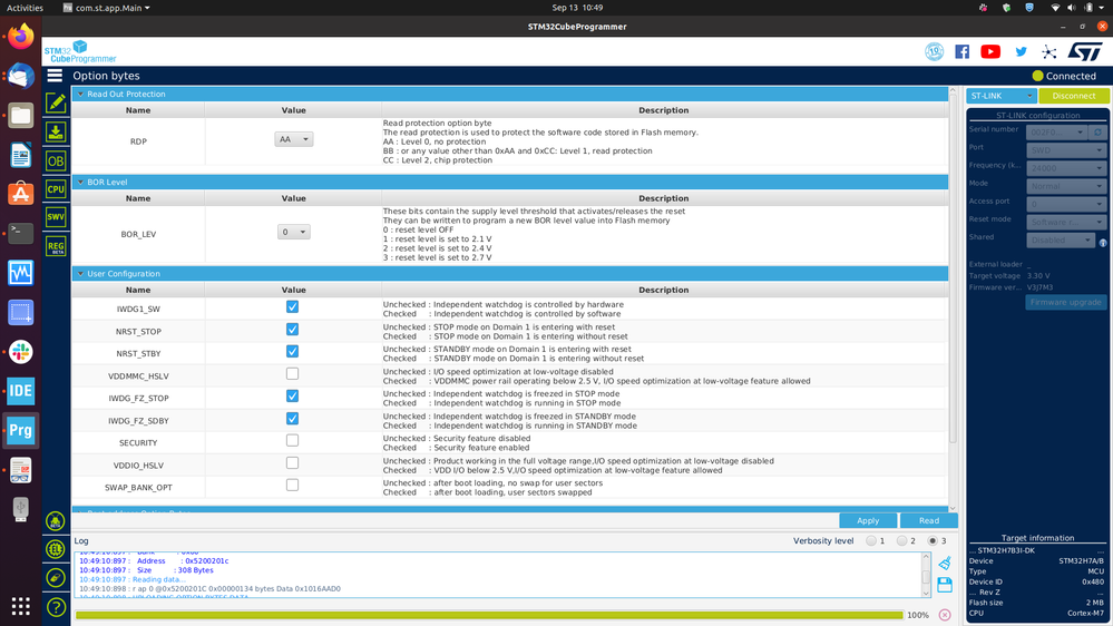

STM32H7 cannot program anymore after running example of SBSFU example (1 Image) for STM32H7B3.
  • September 13, 2021
  • 1790 views
the stm32programmer can connect, erase whole chip, but cannot program.
What I have done is to run example of SBSFU example (1 Image). I can see bootloader running. Then I try to erase the chip to program my other program.

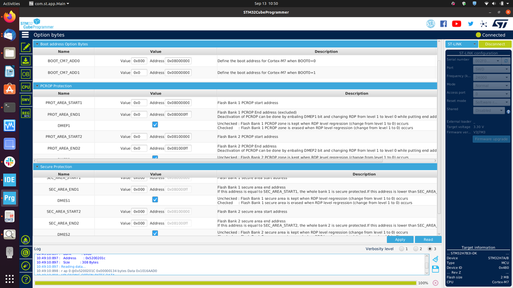

I try to load the PCROP and secure section from my coworker's setting, but it does not allow me to change.
I attached all the stm32programmer logs.
May I know anyway can solve this lock program, or this device is actually locked

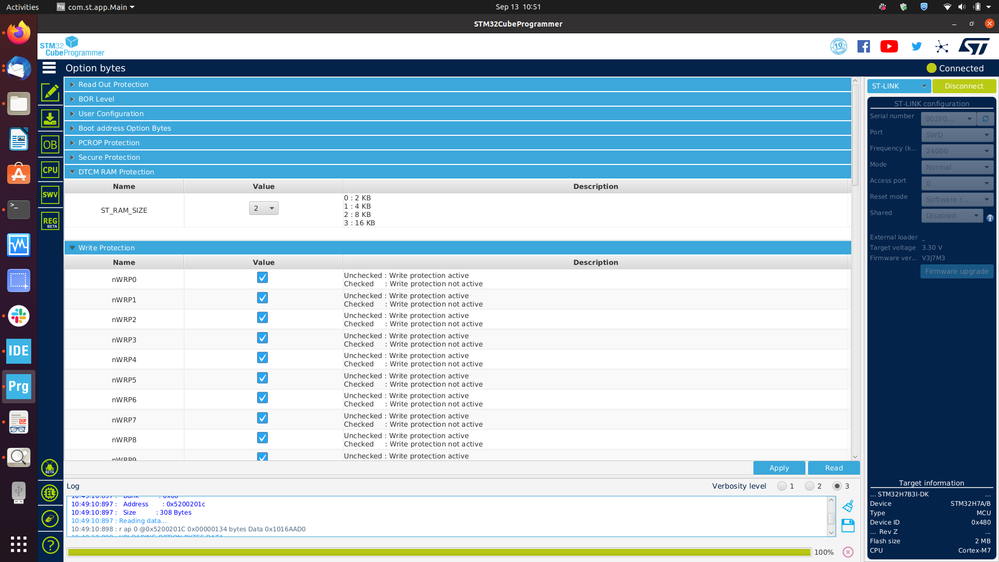

Hi @jiangpen​ ,
I think this may be related to the secure memory configuration, see appendix I in UM2262. Have you considered that?
J
Jocelyn RICARD
September 22, 2021
Hello @jiangpen​
your option bytes have definitely not the good value.
Here is what you should get:
