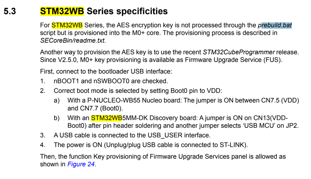

We are developing a product based on a STM32WB5MMG. We have configured the SBSFU with OTA (Asymmetric with AES encryption scheme). Everything is working great and I have only one question that came to my mind during the last commit...
The CBC key for decrypting/encrypting the code is stored in the KMS of the CPU2. The SBSFU is supposed to read from there the key to decrypt new updates. So, why is the key also embedded in the binary of the SBSFU itself, in the se_key.s file? Basically, anyone who has access to the repository can have access to the encryption key (and in our case, being a team with more than one developer and with the potential to collaborate with external parties, this is undesirable). (I'm going to remove the se_key.s from the repo in the meantime). But most of all, what is the point of using the KMS if the SBSFU image itself contains the key?
I'm sure I've missed something and would be very grateful if someone could help me understand it.

Hello @thealbertdev ,
Thank you for raising this point. I think this is a mistake!
STM32WB is the only one chip that has this CKS to store symmetric key. And it looks like code used to generate this symmetric key inside SBSFU was not removed in this case.
One simple thing you can do is to remove the part generating SE_ReadKey_1 in the prebuild and you are done.
I will raise the point internally

thealbertdev
I expect this:
But I see that prebuild.bat edits se_keys.s
(Using X-CUBE-SBSFU 2.6.2 and folder 2_Images from P-NUCLEO-WB55.Nucleo).

I see that SE_CRYPTO_AES_ReadKey uses SHCI_C2_FUS_LoadUsrKey in P-NUCLEO-WB55.Nucleo/Applications/2_Images/2_Images_SECoreBin/Src/se_crypto_bootloader.c. So, why is se_key.s edited and needed??
I have checked that is needed to access the public key of the asymmetric key. But is mandatory to contain the private key?
