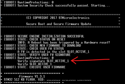

I also tried your proposal. I added trace output to SFU_IMG_VerifyActiveImg() (I guess this is the location you meant to check!?) and found it already called only once during booting as you can see in the logs below.
(this is a debug build, same behavior with release)
ECDSA takes around 5s to boot. Actually the boot time wouldn't be so problematic but we have to integrate into an existing FW-Update chain and with the ECDSA also the installation time increases dramatically on the STM32G0 which triggers timeout issues during install... that's why I swapped to AES GCM. I'll check the possibilities also in this direction!
