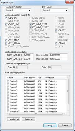

Hello, I would like updating the firmware of an STM32F767ZI using the internal boot loader. I am using the USART3 (PB10 and PB11). In order to transfer the program I am using the program �Flash Loader Demostrator�.
My testing application has two parts. A led blink implemented in the main loop and the jump to the internal boot loader implemented in and EXTI interrupt. In that way when I press a button the application jump to the internal boot loader code and starts the updating process.
When I press the button and I star the communication with the flash Loader everything seems ok:
When I try reading the firmware appear the following message:
I try enabling the reading with the Flash Loader:
The program informs that the memory will be erased. After the process the result is:
When I try reading the program the result is the same as before:
If I use the ST_LINK Utility I can read and write the memory without problems. The configuration of the Option Bytes is:
I have tested the same process with STM32F407 and everything works fine.
Can anyone help me?

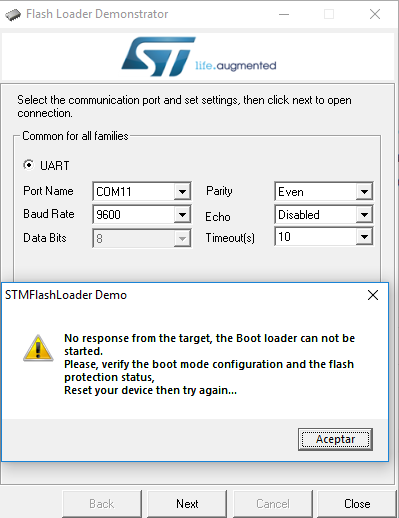

Daniel Collado
June 14, 2018
Posted on June 14, 2018 at 17:18
Hi, I am also trying to use the internal bootloader but in my case I do not even stablish conection with the board, the error says to verify the boot mode configuration because the Boot loader cannot be started (image attached). I have connected boot0 and boot1 to '1' and '0' respectively and connected the board with usb and got virtual COM11, but fails. What else should I do? I tried all baudrates but nothing.0690X0000060L4qQAE.png
