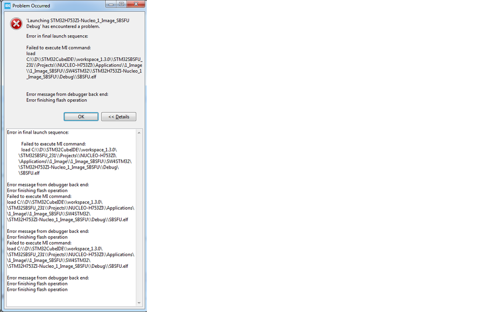

Update 23/07/2020:
I was able to run it in debug again, for some reason debug configurations changed and was setup incorrectly.
Hi Everyone, after trying to port the H753 to H755(Someone else had borrowed my H745 but both of them are extremely similar), I was still not able to sucessfully execute the full process SBSFU example. I was able to load SBSFU but it is still not able to reach the part where it prints out to the serial terminal. There was an instance where I was able to run the example in debug on the IDE but after some flashing a few times, I have been getting an error when trying to run it in debug.
The console of STMCubeIDE says:
Download verified successfully
Target no device found
Error in initializing ST-LINK device.
Reason: No device found on target.
Failed to restart ST-LINK connection
Error in STM32CubeProgrammer
Error in executing 'detach' command ...
Debugger connection lost.
Shutting down...
The following pop up appeared.
Unfortunately once this has been triggered, I am not able to execute or run the board in debug anymore and it has made it even harder.
Has anyone encountered this before because I cant seem to find much on this in other threads and it is blocking me from progressing.
Thanks in advance for any help !

DN_1
In fact that was what I did, what I didnt do was resize the popup before I closed it :grinning_face_with_sweat: .
could you try using STM32CubeProgrammer to fully erase the board?
Maybe you didn't deactivate the protections in SBSFU (app_sfu.h), leading to protection activation.
