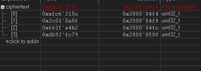

I am getting the output of:  -5c- -21- -c6- -af- -f- -a- -1- -2c- -b2- -a4- -2f- -66- -79- -fc- -92- -db-

I get 981e09865ee3f41ea3d5fc7981166d94
I am still lost on why the discrepancy exists.  Did lots of looking and read much documentation and posts, but no luck.  Any help would be much appreciated.

August 15, 2024
Hello @CatChips ,
in fact, this is a problem with the python script and not with the calculated value in the STM32.
the last four Hex digits in the initialization vector should not be used in the python script here you will find attached a version of the script implementing your desired test with the same calculated value in the STM32 as well as the main.c config used.
 here is the calculated cipher with the script:
and here is the calculated cipher with the MCU:
Regards
Tesla DeLorean
Guru
August 15, 2024
You've got endian issues with your IV, pass the array as bytes to be consistent

CatChipsAuthor
August 16, 2024
Thank you so much @STea and @Tesla DeLorean ! This is very helpful!  I am now able to get the same results for a single encryption.
