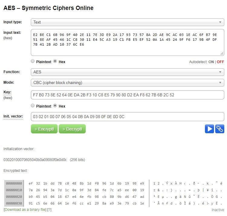

Ok, this online calculator was written by someone competent
http://aes.online-domain-tools.com/
Own PC side AES in C
KEYLENGTH:24
0000 : F7 B0 73 8E 52 64 0E DA-2B F3 10 C8 E5 79 90 80 ..s.Rd..+....y..
0010 : D2 EA F8 62 7B 6B 2C 52- ...b{k,R
IV:16
0000 : 03 02 01 00 07 06 05 04-0B 0A 09 08 0F 0E 0D 0C ................
PLAIN:64
CRC32 9783A6CF
0000 : E2 BE C1 6B 96 9F 40 2E-11 7E 3D E9 2A 17 93 73 ...k..@..~=.*..s
0010 : 57 8A 2D AE 9C AC 03 1E-AC 6F B7 9E 51 8E AF 45 W.-......o..Q..E
0020 : 46 1C C8 30 11 E4 5C A3-19 C1 FB E5 EF 52 0A 1A F..0..\......R..
0030 : 45 24 9F F6 17 9B 4F DF-7B 41 2B AD 10 37 6C E6 E$....O.{A+..7l.
ENCRYPTED:64
CRC32 5B3B8059
0000 : EF 32 1B DD 78 C0 48 8B-1D F0 96 1D 6B 19 98 E9 .2..x.H.....k...
0010 : 7A 26 94 3A 7D 1C 0A 9F-3D 84 FE 7C A5 EE 00 19 z&.:}...=..|....
0020 : B9 45 B5 04 18 67 E4 4E-FB 98 CB 80 9B D6 47 AD .E...g.N......G.
0030 : 91 C5 6E 66 64 1E F6 CC-E1 29 8A E9 3E 79 CB 1E ..nfd....)..>y..
DECRYPTED:64
CRC32 9783A6CF

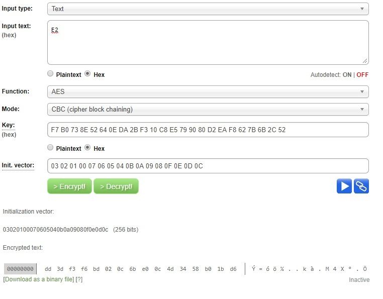

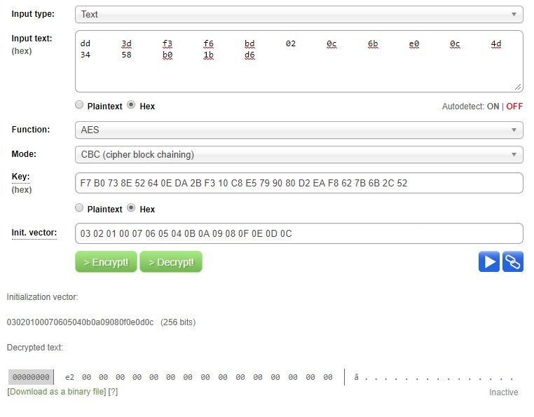

1.when I give a 1 byte(8 bit) of input data the output encrypted text is about 16 bytes(128 bits).. Is the length of encrypted data has a minimum length of 16 bytes?.. i have cross verified the result and its correct(inserted as images)

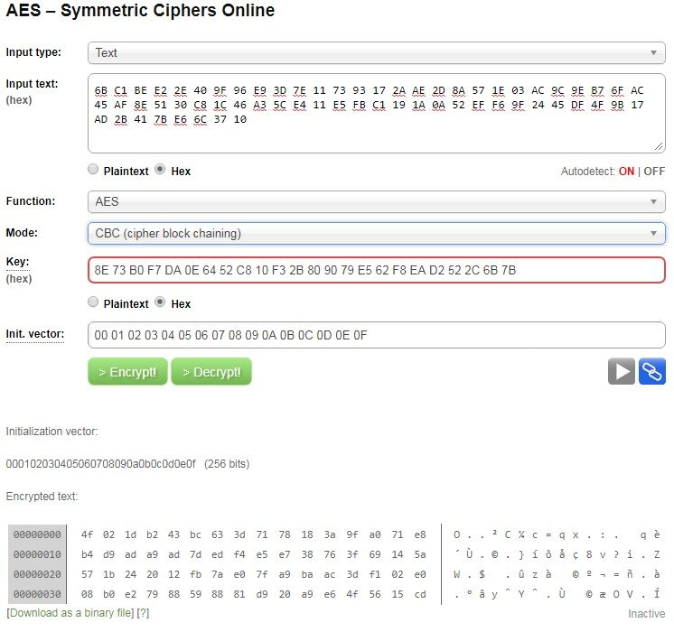

2. In the stm32h7xx library example the encrypted text array does not match with the encrypted text obtained from the website..kindly help for a clarification
FROM LIBRARY EXAMPLE:
uint32_t AESKey192[6] = {0x8E73B0F7 ,0xDA0E6452 ,0xC810F32B ,0x809079E5 ,0x62F8EAD2 ,0x522C6B7B};
/*Initialization Vector*/
uint32_t AESIV_CBC[4] = {0x00010203 , 0x04050607 , 0x08090A0B , 0x0C0D0E0F};
/* Plaintext */
 uint32_t Plaintext[16]     = {0x6BC1BEE2 ,0x2E409F96 ,0xE93D7E11 ,0x7393172A ,
                   0xAE2D8A57 ,0x1E03AC9C ,0x9EB76FAC ,0x45AF8E51 ,
                   0x30C81C46 ,0xA35CE411 ,0xE5FBC119 ,0x1A0A52EF ,
                   0xF69F2445 ,0xDF4F9B17 ,0xAD2B417B ,0xE66C3710};
/* Expected CBC Ciphertext with AESKey192*/
uint32_t CiphertextAESCBC192[16] = { 0x4F021DB2 ,0x43BC633D ,0x7178183A ,0x9FA071E8 ,
                  0xB4D9ADA9 ,0xAD7DEDF4 ,0xE5E73876 ,0x3F69145A ,
                  0x571B2420 ,0x12FB7AE0 ,0x7FA9BAAC ,0x3DF102E0 ,
                  0x08B0E279 ,0x88598881 ,0xD920A9E6 ,0x4F5615CD};
Encrypted Text from website:
ENCRYPTED:64
CRC32 5B3B8059

Not sure I can invest that much time into this. Would probably look to see if there are some endian issues with the settings.
Tesla DeLorean
Guru
May 1, 2020
hcryp.Init.DataType  = CRYP_DATATYPE_32B; // Takes data Big Endian format
