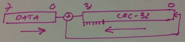

The problem here really is an endian/shift direction one. In terms of what the polynomial is doing, it is the high order 6-bits.
The 8-bit data is LSB first right shifting, and the CRC is 32-bit left shifting 0x04C11DB7. In order to be computationally efficient it makes more sense to stand the CRC on it's head so the data and the CRC shift in the same direction, and a single XOR is required to merge the two bit streams. One could do it in the normal sense of the CRC, but this would require a bit reversal of each data byte. As a bonus, we have the seeding of CRC-32, and the bit-inversion at the end, basically making sure 0x00 bytes generate a check sumUp vote any posts that you find helpful, it shows what's working..

Hi Clive
I am not a good enough mathematician to see all details without a lot of study but the HASH in the Freescale devices (Coldfire and Kinetis - using both big and little endian) is calculated using the same CRC code with the polynomial direction reversed (for efficiency as in yours): see http://git.ti.com/keystone-linux/linux/blobs/8d82f219c2d476811cd3157a39c7b5c1f045ebc3/drivers/net/ethernet/freescale/fec.c Here they also specify that the HASH is the ''6 MSbits of the CRC'' and to get the 6 bit HASH value they shift 26 bits to the right. I don't see the difference with your CRC32 calculation - they give the same 32 bit values - but in the ST case the 6 LSBs are used after negating and bit inversing and in the Freescael case the 6 at the other end are used. This tells me that there is a difference in the implemention (as to which CRC bits are fed to the HASH logic) rather than in the terminology. But as I said, I'm good with it. I'm no mathematician - just a coding monkey and now what comes out is correct so whatever I am putting in must now be good... Regards Mark- Mark as New
