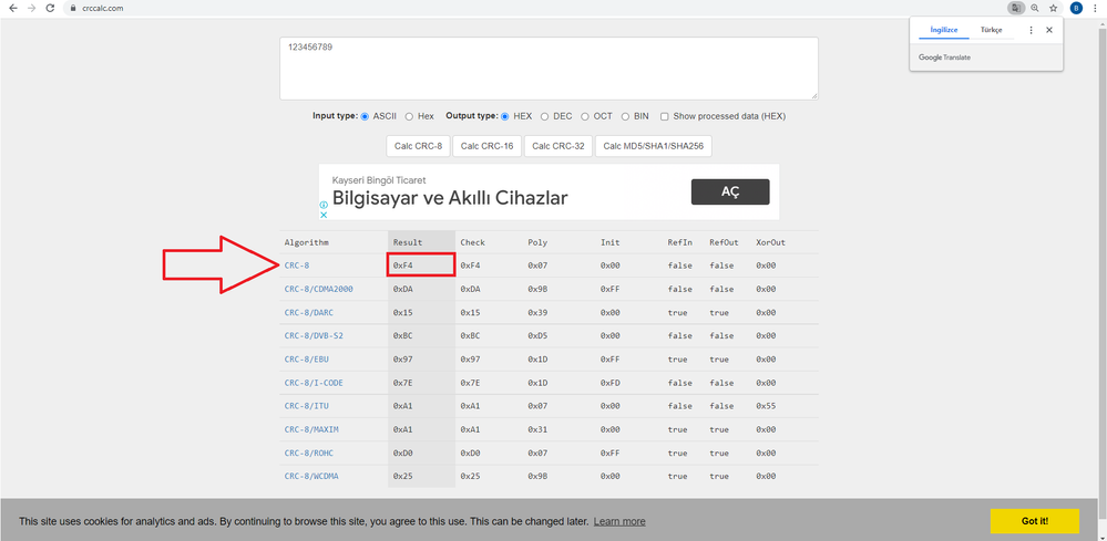

I'm having trouble calculating crc. I am using STM32F401 with cube ide.
The correct crc occurs on crccalc.com. But I couldn't run CRC-8 with MCU. I have looked at the examples, but when I try it gives different results.
Can you provide a working code example?

I must use CRC-8, http://smbus.org/faq/crc8Applet.htm
x8+x2+x+1
i don't know how to calculate this crc-8 with mcu :(
When I calculate via http://crccalc.com, input: 171D00, result is 0A (this is ok)
I couldn't get this result when I calculated it with mcu.
I tried the library here. But the result does not match
https://stm32f4-discovery.net/2015/07/hal-library-10-crc-for-stm32fxxx/
Thanks for help
