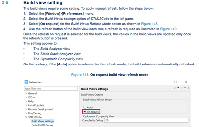

I hope this message finds you well. I am encountering an issue where I cannot access the RAM and Flash usage statistics within the Build Analyzer feature of CubeIDE version 1.15.1. Upon attempting to view these metrics, the fields appear empty, preventing me from effectively monitoring and optimizing my project's resource utilization.
Could you kindly assist me in resolving this issue? Your guidance on how to properly access or troubleshoot these metrics would be greatly appreciated. I am eager to continue developing my project efficiently but am currently hindered by this limitation.

Hello @Hitesh_Aratek
You have to click on the "Refresh" button:
Please, refer to the User Manual, section 2.5 where this new button is explained and how you can change the behavior:
Best Regards.

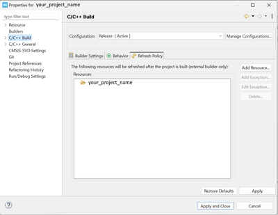

Hi @Hitesh_Aratek
I believe the problem is because you imported the project from 1.14 to 1.15, but somehow the refresh policy is not up to date.
In the project properties, on C/C++ build there is a tab "Refresh Policy" where you should select (or reselect) your project folder :
Do not forget to do so for both Debug and Release configurations.
