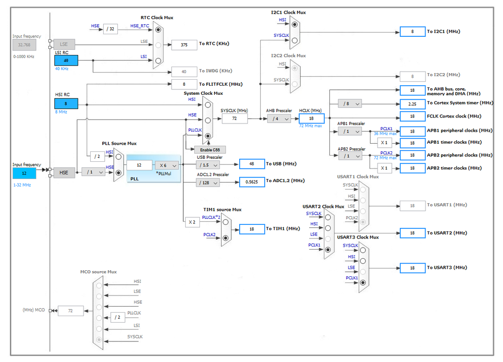

My program crashes with the following error in TrueStudio:
''Program received signal SIGTRAP, Trace/breakpoint trap.
0xfffffffe in ?? ()''The fault occurs in line 692 of stm32f3xx_hal_rcc.c:
__HAL_RCC_SYSCLK_CONFIG(RCC_ClkInitStruct->SYSCLKSource);
If I change
HAL_RCC_ClockConfig(&RCC_ClkInitStruct, FLASH_LATENCY_0)
to
HAL_RCC_ClockConfig(&RCC_ClkInitStruct, FLASH_LATENCY_1)
everything works fine.
I use an external 12 MHz clock source and this configuration in CubeMX 4.25.1:
According to RM0365 the flash access time depends on HCLK not SYSCLK like in RM0008 (STM32F1...), but I tried two other configurations which indicate that flash latency should rather be set according to SYSCLK:
SYSCLK = 72 MHz, HCLK = 9 MHz -> program crashes
SYSCLK = 48 MHz, HCLK = 12 MHz -> works
Did I overlook something else or is this a bug in the reference manual / CubeMX?

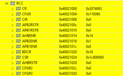

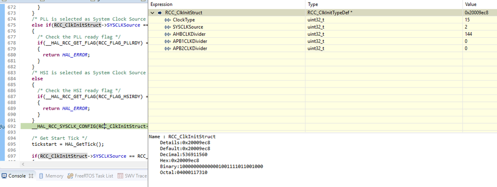

Is RCC_ClkInitStruct properly initialized (i.e. filled all its fields)?
Read out and check/post the RCC registers' content just before that line.
‎2018-05-21 12:36 AM

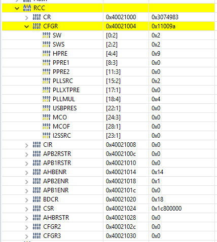

Before __HAL_RCC_SYSCLK_CONFIG:
After __HAL_RCC_SYSCLK_CONFIG:
RCC_ClkInitStruct:

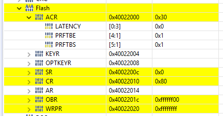

One more thing from reading the RM:
The prefetch buffer must be kept on (FLASH_ACR[4]=’1’) when using a prescaler different from 1 on the AHB clock.
Can you please read and check FLASH_ACR?
‎2018-05-21 6:05 AM
Prefetch buffer is enabled, when the fault occurs:
