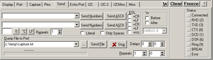

    wwmentz
    Visitor II
    January 18, 2018
    Posted on January 18, 2018 at 16:15
    Tesla DeLorean
    Guru
    January 18, 2018
    Posted on January 18, 2018 at 16:44
    Correct, and RealTerm can display Hex bytes, and the 'Send Numbers' can dispatch strings of hex bytes directly. I've used it to interact with the STM32 System Loader, sending commands and data.
