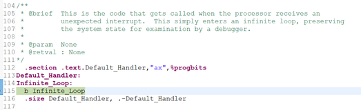

My thoughts: BTW: it is an assembler code instruction "b InfiniteLoop" (a brunch to itself, as endless loop).
This happens usually if you get an interrupt fired but there is not an INT Handler provided for this vector (the default one used).
I guess, potentially it is not the code you assume. It looks more like an INT gets active without a handler provided.
Is your TIM maybe configuring an INT (what is in HAL_TIM_Base_MspInit() ?), but the TIM IRQ Handler is missing?
Try to debug and check in the MCU/NVIC registers which INT vector was activated.

Thanks for your reply but I did not enable the timer interrupt so there should be no interrupt signal from the timer. But even when I enabled the timer interrupt and write the timer_ISR to clear the flag bit, and give it a priority of (0, 0) preamation, and subPriority the problem still the same. The program is stuck in EXTI_ISR.
How do you know it's EXTI_ISR?
Observe SCB_ICSR.VECTACTIVE to find out which ISR is currently serviced. It may be a fault, too (probably HardFault). You are using float - do you have the FPU enabled?

It is potentially not stuck in EXTI_ISR! It can be any INT coming but not an INTHandler provided for it.
Yes, it can be also due to using floating point and amusing to use HW FPU but not enabled (your compile options enable to use FPU but your code does not enable FPU).
I do not see a "division by zero" or a calculation resulting in an FPU error. Anyway: even the FPU can fire an error (when code tries to use it but not enabled on your startup).
Yes, you have to check which INT is triggered (it can be also a watchdog) and find the "missing INT handler".
Any INT fired which does not find an implementation of an INT Handler jumps to "DefaultHandler".
Please, check which INT was triggered. It is potentially one for which you have not implemented an INT Handler. The MCU registers, NVIC registers, will tell you what was the INT vector number (INT source).
Check your code generation settings: for instance: HW FPU to use but not set properly to enable to initialize FPU.
(there are macros, e.g. FPU_PRESENT, to do so)

Thanks everyone,
I have enabled the FPU and the code worked fine.
