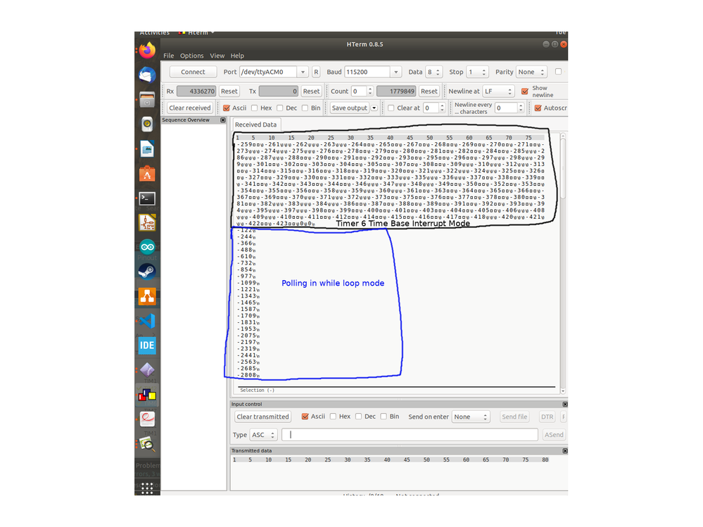

Greeting Everyone,
May I have some little help here? I'm currently using STM32F303K8. I had experimented with HAL_UART_Transmit_DMA function within "the main while loop" and the TIM6_DAC1_IRQHandler(void) which was called from TIM6 in Time Base mode
My application is to send the current encoder count by UART. It'd be better to send with an determinable rate, that's why I prefer to use Timer.
Here's part of my code when using polling mode(main.c)
/* USER CODE BEGIN 2 */
 HAL_TIM_Encoder_Start(&htim2, TIM_CHANNEL_ALL);
 HAL_TIM_Base_Start_IT(&htim6);
 //HAL_UART_Receive_DMA(&huart2, pData, Size)
 /* USER CODE END 2 */
 /* Infinite loop */
 /* USER CODE BEGIN WHILE */
 while (1)
 /* USER CODE END WHILE */
 /* USER CODE BEGIN 3 */
 char buffer[12];
 int n = sprintf(buffer, "%ld\n", TIM2->CNT);
 HAL_UART_Transmit_DMA(&huart2, buffer, n);
  HAL_Delay(200);
 /* USER CODE END 3 */
Here's when it's come to Timer interrupt mode(stm32f3xx_it.c)
void TIM6_DAC1_IRQHandler(void)
 /* USER CODE BEGIN TIM6_DAC1_IRQn 0 */
 /* USER CODE END TIM6_DAC1_IRQn 0 */
 HAL_TIM_IRQHandler(&htim6);
 /* USER CODE BEGIN TIM6_DAC1_IRQn 1 */
 char buffer[12];
 /* USER CODE END TIM6_DAC1_IRQn 1 */
Clock running at 64MHz
TIM6->PSC = 6399 and TIM6->ARR = 1999
So, the expected interrupt rate is 5Hz (similar to delay(200 ms))
I'm really curious about this, since the frequency is very low, it should have no problem, or am I missing any point?

I think that’s happening because you define the buffer inside the TIM6_DAC1_IRQHandler.
Try to use a globally defined buffer.
April 27, 2020
What @Gabriele says is almost certainly the culprit.
However you should also check the return value on HAL_UART_Transmit_DMA to ensure everything worked HAL_OK.

Thank you so much, now the data flow like what I expected. But I'm little curious what's the technical reason behind that problem?
waclawek.jan
April 28, 2020
The buffer defined within the ISR is a local variable defined on the stack. Once you leave the ISR, whatever is on stack stops to be valid, and other routines using stack may rewrite it.
This is fairly standard C feature. If you want the buffer be persistent, use the static keyword when defining it.
