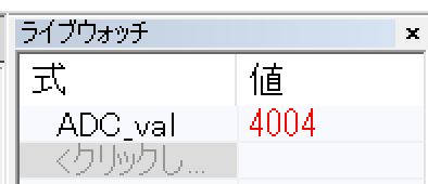

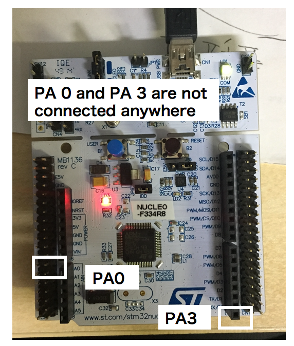

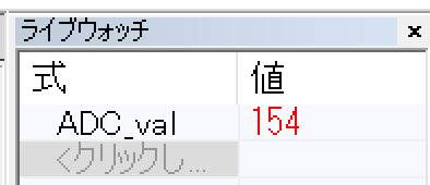

I'm using STM32F334Nucleo.
Nucleo's PA 3 terminal indicates about 3.3 V in ADC in a situation where nothing is connected.
On the other hand, the PA0 terminal shows about 0V in the AD conversion in a situation where nothing is connected.
Why do these two differ?

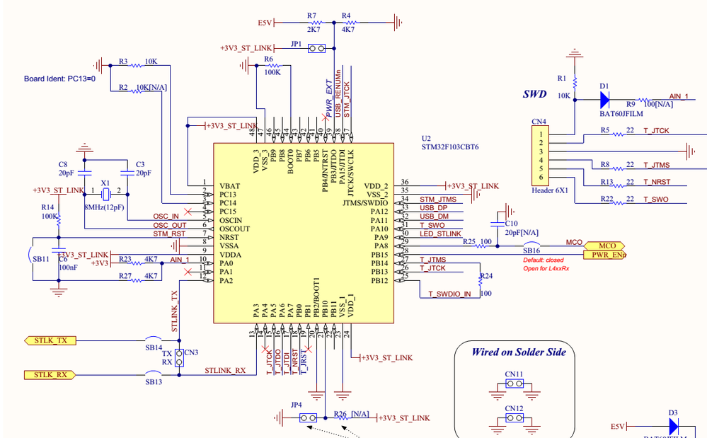

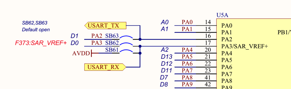

Probably because it is connect to the VCP USART from the ST-LINK. Review the schematic

Zt Liu
Senior III
Posted on July 25, 2017 at 02:57
this is your target mcu
belowed is your st-link
you should probably removed SB13 and connect SB62
Posted on July 25, 2017 at 03:46
Or just use the pins designated for the Arduino analogue interface.
