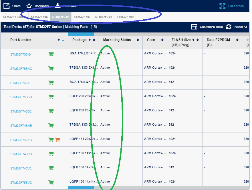

Hi:
   Are there any documents mentioned about chip selection for upgrading from STM32F4 to STM32F7? I find a document AN4660 talking about migration, thus I know STM32F756 is the candidate. However is there any table said about device mapping for upgrade. For example If I use STM32F427IIT 6(LQFP176), which device I can choose for STM32F7?

    Walid FTITI_O
    Visitor II
    July 14, 2016
    Posted on July 14, 2016 at 11:37
    Hi Calvin63,
    It is mentioned in the application note
    http://www.st.com/content/ccc/resource/technical/document/application_note/73/76/21/47/ef/d0/4c/16/DM00164538.pdf/files/DM00164538.pdf/jcr:content/translations/en.DM00164538.pdf
    ''Migration of microcontroller applications from STM32F42xxx/STM32F43xxx to STM32F74xxx/STM32F75xxx? :
    ?The STM32F74xxx/F75xxx devices are fully pin-to-pin compatible with the STM32F42xxx/F43xxx devices except for the LQFP100 package..?
    So for your case, with STM32F427IIT 6(LQFP176), you will be fully compatible with STM32F74xxx/F75xxx
    For the website , you can see the STM32F7 details in the dynamic table of product? Parts inside the
    http://www.st.com/content/st_com/en/products/microcontrollers/stm32-32-bit-arm-cortex-mcus/stm32f7-series.html?querycriteria=productId=SS1858
    : as you see in figure bellow, in the blue circle the possible selection of derivative micros and in green circle the marketing status.
    -Hannibal-

    Tai.Cheng Chung
    July 15, 2016
    Posted on July 15, 2016 at 04:12
    Hi:
          Thanks for waclawek's http://stmcufinder.com link, it's very helpful.
          Thanks Hannibal's device selection table link, it tells me, the table is still exist, just I can't see it. I used to see the table with chrome but it's gone for a long time. I open the link by IE, the table comes back, so I go back to chrome and adjust the web setting (website enlarge/shrink feature), the table comes back also. The font in the table is not proper located, but it is there.
       I never use STM32F7 series, this series is new to me, without the table, I don't know how to select device candidate. The problem is solved now.Thanks you all.
