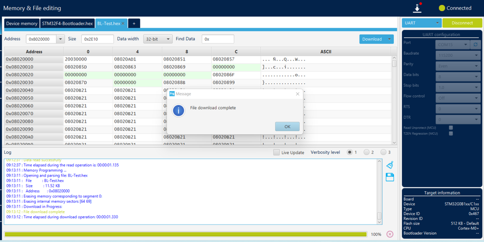

I'm working on Custom boot loader based on Openbootloader by ST, existing example is based on STM32G0/G4 series but I'm using STM32F417 and there are losts of differences in terms of internal flash memory architecture(G0 to F4 series) and HAL/LL library also,
I made losts of changes in existing example to make it run on STM32F4, while using
STM cube programmer showing read flash successful and write flash also, but there is no data on desire location, The issue is bad configuration of Options byte and write protection,
So I want to know what's the process to write the data in flash?
Thanks

    It's not clear if you're trying to upload a program (since you mention HAL/LL and code updates), or if you're trying to edit individual data bytes. Can you clarify?
    Screenshots of the errors or what you expect vs what you see would help.

    Well the memory of the Flash in the F4 is more complex than others.
    Are you using the UART protocol, or something else?

    Yes, I'm using UART protocol
    See above attached image every thing is fine (read/ write)
    but if i varify the memory its showing fffffffffffffffffffff
    ​as show in below image
    June 13, 2023
    Click "Read" again so it updates the memory. Your log should have "Time elapsed during the read operation is: ..." as its last line. If you look at the log, the last read operation was prior to the download.

    I was trying to write flash by Openbootloader, Now everything is working,
    STM32F417 working on openbootloader,
    Issue was "Not able to write as Dword, change to word" to make it run.
    thanks to all for your help
