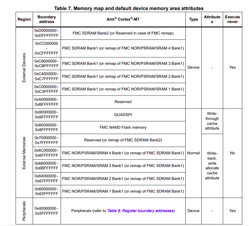

I'm having trouble making use of SDRAM (external device memory) on the STM32H743 EVAL2 board. Specifically, I'm trying to make use of FMC SDRAM Bank 2 (Region: External Devices) to store a large array.

 SDRAM (xrw)	 : ORIGIN = 0xD0000000, LENGTH = 64K

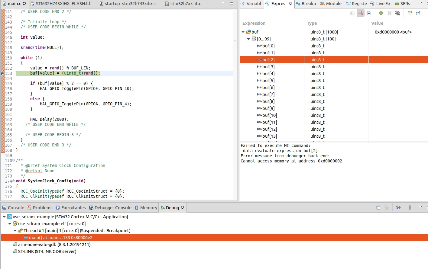

    0693W00000BaL7OQAV.pngThanks! With this addition, I can now launch the program. However, if I try to access/read/write to buf, I get a hard-fault error. In the debugger, when I try to view an entry in buf, I am shown this error (specifically, this is me checking buf[2] explicitly)
    Failed to execute MI command:
    -data-evaluate-expression buf[2]
    Error message from debugger back end:
    Cannot access memory at address 0xd0000002

    June 7, 2021
    Recheck your SDRAM parameters. Yours do not match those found in the examples for that board.
    Also, you need to do more than just call HAL_SDRAM_Init. Again, see the example.

    June 7, 2021
    Yes, it makes sense.
    Take the SDRAM parameters and initialization from the example, but keep your initial linker script (with NOLOAD added). You were almost there except you weren't initializing SDRAM properly, so just take that part from the example.
