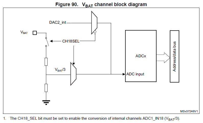

I'm updating an old PCB design that used the STM32L432KB. The new design is using the STM32L452CE which has the Vbat pin.
In the old design I used a voltage divider across the battery and connected it to an ADC pin to periodically check the battery level.
In the new design instead of using a voltage divider to an ADC pin can I use a connection from the positive terminal of the battery straight to the Vbat pin?
I don't wish to use Vbat as a backup power supply or any of the other feature, just as an ADC input since the board is to be powered with the battery only.
Yes. Possible.
Below is the image snapshot from
http://www.st.com/content/ccc/resource/technical/document/reference_manual/group0/b0/ac/3e/8f/6d/21/47/af/DM00151940/files/DM00151940.pdf/jcr:content/translations/en.DM00151940.pdf
Couple of points:
  1. Enable the bridge (CH18SEL) only during measurement. else it will drain battery continuously.
  2. The read analog value represents will be one third of the actual battery voltage.

If the battery is 4.6V, the vbat gpio maynot be 5v tolerant, hence make sure not to beleive 5/3 will solve it...

Check the normal operating input voltage of vbat to make sure weather the battery can be direct connect to vbat pin or not. As i recall, the adc will have an inyernal divider to scale the voltage within mid range of the adc. It has a power switch to reduce leakage. Using vref adc channel, the accurate vbat voltage can be calculated properly.
If the vbat is 5v, it would probably require an external divider...
