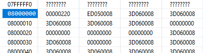

Yes: try to boot from flash ("normal"), have debugger connected and try to stop debugger, step with debugger... which code is executed? Where are you in code execution?
I assume (still): you create a code image which works fine when debugger loads code to SRAM - but it cannot run the code from flash ROM (as "normal", potentially no code in flash ROM).
Use the debugger in order to check:
  • do you see your code flashed in flash ROM (0x08000000)?
  • can you step in code and does it make sense?
  • can you check your linker script (if it would just assign to be loaded into SRAM and not generating code
    to be stored in flash ROM)?
  • Do you have any other example project which boots code from flash ROM?

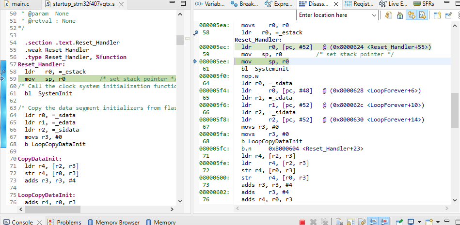

Just boot in "normal" mode, connect with debugger (the running session) - check what is in flash memory, what is on SRAM, where is the Program Counter (PC, which code does it try to execute)...
Or:
Set a breakpoint in debugger mode on the very instruction done (not on main(), instead a breakpoint on first instruction in ResetHandler.
Set compile options to "-g" and "optimize for debug".
Try to figure out if SRAM is initialized (startup.S was working), if code was written into flash ROM... how the code jumps (in "normal" mode), if startup.S has initialized SRAM...

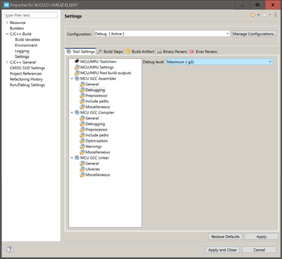

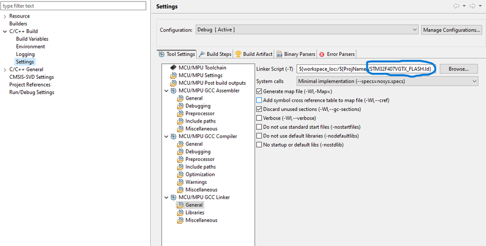

I checked my project uses either FLASH or RAM by looking here.Ekran Alıntısı.PNG
In my STM32F407VGTX_FLASH.ld file. It seems OK.

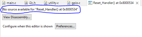

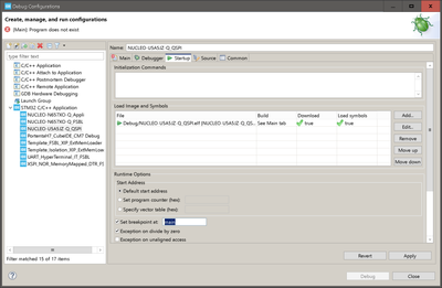

 and I realized somehing I have tried running it several times later on and was receiving this message Ekran Alıntısı.PNG
This must be the problem causing everything goes bad. What should I do at this point. I am quite confused.
