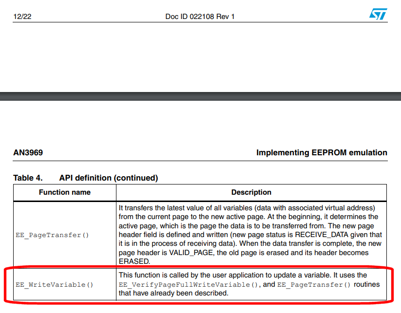

Did you study the Application Note, which describes what this code does, and how to use it?
https://www.st.com/resource/en/application_note/an3969-eeprom-emulation-in-stm32f40xstm32f41x-microcontrollers-stmicroelectronics.pdf#page=13
As that description says, the EE_WriteVariable() function updates a Virtual Variable in the emulated EEPROM.
See also the documentation in the source code itself:
* @brief Writes/updates variable data in EEPROM.
* @param VirtAddress: Variable virtual address
* @param Data: 16 bit data to be written
* @retval Success or error status:
* - FLASH_COMPLETE: on success
* - PAGE_FULL: if valid page is full
* - NO_VALID_PAGE: if no valid page was found
* - Flash error code: on write Flash error
So that's writing 16-bit data - or two characters at once.
You will need something like:
