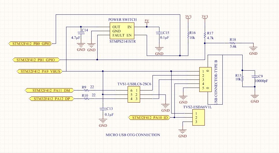

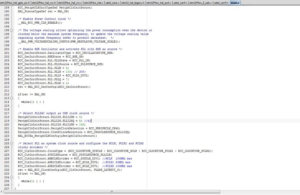

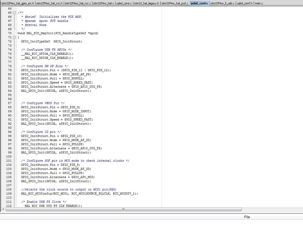

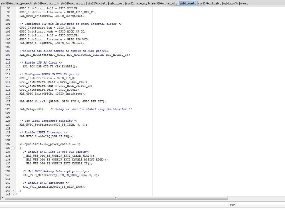

Hi shingadaddy,
Thanks for your reply and here are the answers for your questions.
I am NOT using a demo board and have my hardware already designed.
I have tried ''porting over an HS app to a FS app'' and I gave up as it didn't work. I'm currently trying the application at ''STM32Cube_FW_F4_V1.14.0\Projects\STM32F412G-Discovery\Applications\USB_Device'' because it is the same chip ''STM32F412'' but I had to change the clock configuration and the USB pins configuration.
I haven't pulled up D+ or D-, neither in software or in hardware and I am using v_bus sensing as in the code it says ''hpcd.Init.vbus_sensing_enable = 1;''
HSE crystal is 16MHz.
I don't think I'm using I2S clock.
Please find the code images with PLL clock configuration, USB pin configuration and the hardware design.
These are the only changes I've made to the example code available at above link.
Thanks very much for your support.!

shingadaddy
Senior
Posted on February 14, 2017 at 21:58
The numbers I see here seem okay as far as NUMBER MATH. Make sure that these numbers are within the range of acceptable numbers for your specific part for each setting. I am pretty sure I've seen complaints of CubeMX generating numbers that were GOOD NUMBERS generally but BAD numbers for specific part capabilities.
Don't know if that's been fixed. Try a few combinations that are within the spec but *other* than THESE numbers and see if that helps. Just so long as your math lands on 48Mhz. According to the TREE in the UM your okay with 16Mhz,  /8 (/2 to /63) , *192 (50 to 432) , /8 (2 to 15)
You must be doing SOMETHING because your VBUS detect must be working and yanking up the D+ (or D-) line since your analyzer saw traffic from PC to device. (PC knows you plugged SOMETHING on)
Um.... Make sure it is yanking up the D+ line for FS and that you don't have the D- getting yanked up by a line swap, which puts the bus speed off in the weeds....
Blinking LED in your LOOP?
All I see seems okay. The LINE swap has bit me before and acts exactly like you are seeing. This quickly comes to your PORT OVER effort.
Did I mention a blinking LED in your loop?
One of the things I have also been bit on was an I/O expander on one demo board (EVAL)where I swiped example code from where the demo app expected communication via I2C or SPI and the board I port to (NUCLEO) didn't have this little trouble maker. No talk = NO RUN. Look out for that sneaky stuff.
shingadaddy
Senior
Posted on February 15, 2017 at 22:54
'Sneaky stuff'  -  I just looked and that DISCOVERY eval board apparently comes with an LCD. There's a good chance that the CUBE eval software
'STM32Cube_FW_F4_V1.14.0\Projects\STM32F412G-Discovery\Applications\USB_Device'    -- AS IS --
probably tries to do some clever stuff with this LCD when it powers up and that means the micro tries to talk to that LCD. And probably expects something BACK from the LCD. If you have no LCD then it doesn't get what it expects and might trigger the infamous ERROR HANDLER FOREVER WHILE LOOP trick I see in some places in the ST stuff. Much like the I/O expander I mentioned. Worth a look maybe ?     Let us know how its going.
