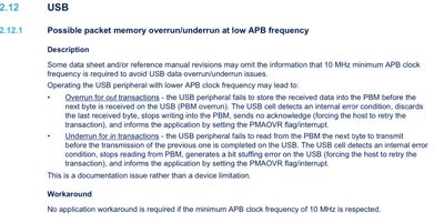

Hi @PGump.1 ,
Can you please try to change the USB port on Your PC connected to the board and if you have a full speed HUB to try to put it in between and try again . I have suspected hypothesis the following, check the minimum APB frequency that is  16MHz .
F0 runs at 48MHz and L0 at 32MHz this may impact the migration and processing of the transactions speed .
let us know .
Ciao
STOne-32
Thanks for the reply.
I had read the Errata notes. I did see that. Initially my APB frequency was 16MHz, I changed it to 32MHz to see if that was the problem, but it made no difference.
