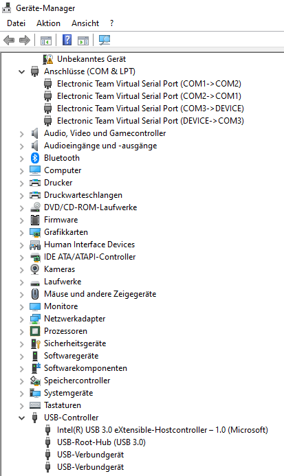

When you plug the board into a Windows PC (with the firmware running) what do you see in Device Manager? in UsbView?
anaeb.1
anaeb.1Author
November 4, 2023
nothing is shown in device maneger, as if i had not connected the board to anything Screenshot (290).png
Pavel A.
November 4, 2023
There's some Unbekanntes Gerat. Is it the board? Will it disappear when you unplug the board?
anaeb.1
anaeb.1Author
November 5, 2023
No, this is a different device that I have been using for months.
