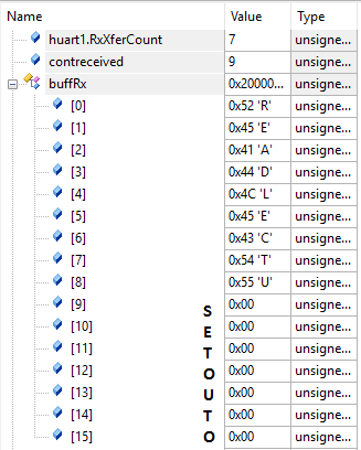

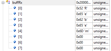

I have a problem at the reception for 4
I use an 8-position buffer where I keep what we receive for USART. When I receive, if the size of the messageis less than that of the buffer, the following receipt is written below what Ialready had. How can I restart the index for this reception buffer?/**

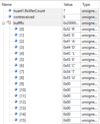

That's what I receive first, and it's OK.
Here is the second reception,which overwrites the first.

HAL_UART_Receive_IT(&huart1, (uint8_t *)&buffRx[n], 16-n)
‎2017-07-07 6:45 AM
Hi Clive, in this code I changed the buffer size to 16
Where I modify the value of n?Thanks- Mark as New
‎2017-07-07 7:07 AM
Your question implied you needed to restart deeper into the buffer. You need to figure that restart point, as index n.
Your images are not viewable by anyone but you, they point to private gmail views. Just attach images via the camera icon.
If the buffer contains multiple messages your parsing code is going to have to be smarter, so it indexes through the array, or it copies down the tail into the front of the buffer.

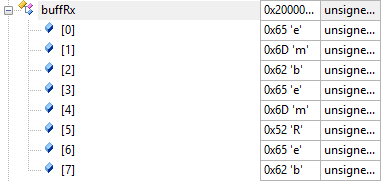

Not sure it's overwriting as much as starting at a different part of the stream, your parsing code will need to be smarter and resynchronize with the start of the data you are looking for.
To see if it overwrites, or is new data, fill the buffer with a known pattern before each start, ie something like 0xCD

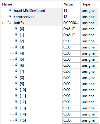

I added a ''resetbuffer'' in the callback, but the only thing I get is to clear the buffer after it has been filled. So what has not fit before, starts to fill the buffer again.
void HAL_UART_RxCpltCallback(UART_HandleTypeDef *huart)
resetbuffers();
void resetbuffers(){
uint8_t i;
for(i=0;i<APP_RX_DATA_SIZE;i++){
buffRx[i]=0;
huart1.RxXferCount= APP_RX_DATA_SIZE;
//UserTxBufPtrIn = 0;
First I'm sending READLECTU, and later SETOUTOFF
