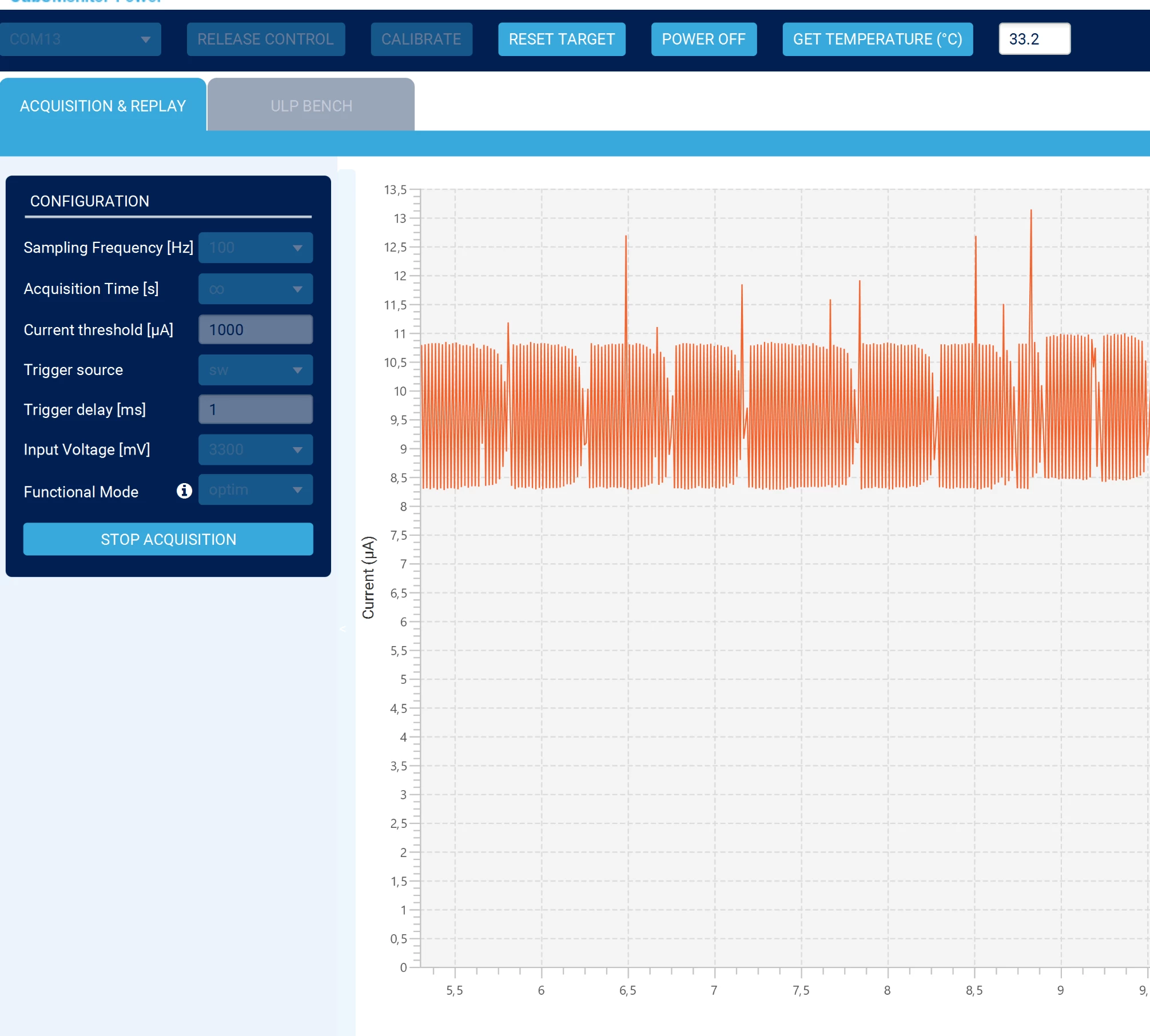

Unexpected Current Consumption in STOP2 Mode on STM32U595
Hi everyone,
I’m facing an issue with power consumption in STOP2 mode on my custom board.
The board includes only the STM32U595 MCU, bypass and decoupling capacitors, and the inductor for the SMPS — nothing else is connected.
According to the datasheet, I expect a current consumption of around 4.65 µA in STOP2 mode (pag 214 Table 59, VDD = 3.3 V).
However, when I measure it with my STLINK Power Monitor, I get about ~10 µA with fast oscillations.
MX configuration:
  • All peripherals are disabled
  • SysClk = 16 MHz
  • All SRAM banks in Power-Down mode
  • Power saving mode enabled
  • SMPS enabled
  • Voltage scale = Range 4
  • All pins configured as analog input (via Project Manager → Code Generator)

Does anyone have an idea what could be causing this higher current consumption in STOP2 mode?
Any suggestions or insights would be greatly appreciated!

@Andrew Neil
Thank you for your quick reply.
No, I haven’t been able to test any examples on an ST board yet, but I used the official examples as a reference.
This is my current hardware setup. The board is actually more complex, but at the moment the only components populated are the ones shown in the photo — all other pins are floating.
