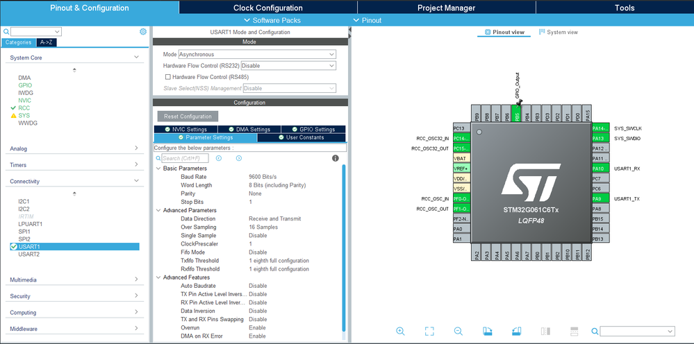

Hi all,
I am using a STM32G061C6T6 MCU. I'm trying to contact Nextion HMI. My data sending is successful, but I can't get any data. I couldn't run any of the Pooling and interrupt methods when receiving data. When I follow the RX pin with the oscilloscope, the data comes, but I can't read it with MCU.
I tried the display on the Nucleo-F103RB card with a simple HAL code. I can read the data from the screen. Do I need to do a special operation on this MCU(STM32G061C6) to be able to read with UART? I'd appreciate it if you could help me.

Bruno_ST
Hello @Fatih Erdoğan​
Do you have the floowing line of code in bold in stm32g0xx_hal_msp.c ?
  /**USART1 GPIO Configuration
  PA9   ------> USART1_TX
  PA10   ------> USART1_RX
  GPIO_InitStruct.Pin = GPIO_PIN_9|GPIO_PIN_10;
  GPIO_InitStruct.Alternate = GPIO_AF1_USART1;
  HAL_GPIO_Init(GPIOA, &GPIO_InitStruct);
If not, please add it.
BR,
Bruno

Hi @Bruno_ST​ ,
I'm grateful to you, the problem is solved. Thank you very much.
