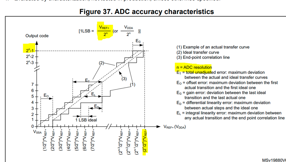

Then you divide by 4095, presumably because you set the ADC to 12bit, right? But why 4095 if it is 12bit, i.e. 2^12=4096?

ad: "4095" vs "4096":
STM32F030x reference manual, page 205
https://www.st.com/resource/en/reference_manual/dm00091010-stm32f030x4-x6-x8-xc-and-stm32f070x6-xb-advanced-arm-based-32-bit-mcus-stmicroelectronics.pdf
VCHANNELx = VDDA / FULL_SCALE * ADC_DATAx
FULL_SCALE = 4095
and now what's right ... ?
Apr 14, 2022 1:13 PM UTC
It should be 4096, however that's well within the noise in this example.
My guess is your VREF+ is not 3.3V or you haven't calibrated it after startup.
