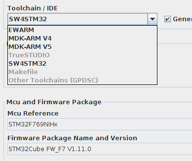

Posted on March 25, 2018 at 12:43
Was attempting to generate a project in CubeMX for the STM32F769I-Disco board for the Atollic TrueStudio and was greeted with this:
Did I miss a step?
Posted on March 26, 2018 at 10:14
I guess it depends on the options you select. On an empty project I get the same. Start adding things like graphics (STemWIN) and TrueStudio isn't an option anymore.

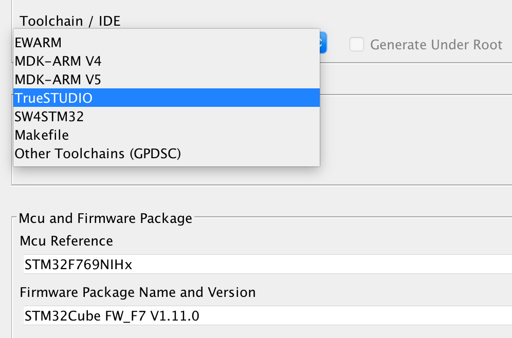

Posted on March 25, 2018 at 15:40
Reinstall. Is it CubeMX 4.25?
This is how it looks on my screen:
Posted on May 28, 2018 at 21:56
Not yet supported as of 4.25.
