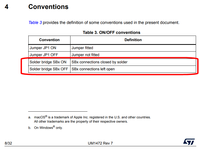

Could someone help identify the part number and range for the SB1 component on the STM32F407G-DISC1 board? I'm interested in understanding its exact specifications.

SB1 is a Solder Bridge. You can find the specifications from:

Usually not, rhey are there to add flexibility in the design without needing physical jumpers.

As already noted, "SB" is a Solder Bridge:
Just like a Jumper ("JP") it allows a connection to be easily made (closed) or broken (opened) - to allow configuration to a user's requirements.
https://electronics.stackexchange.com/questions/261106/solder-bridge-in-schematics-and-0-resistors
They use these Solder Bridges rather than traditional Jumper links because:
  • They are cheaper
  • They are smaller
  • They are easier for board assembly.
In some cases, rather than just use a "blob" of solder, a zero-ohm resistor (aka "zero-ohm link") will be fitted:
https://en.wikipedia.org/wiki/Zero-ohm_link
Here's an example - where SB53 (at the top) is "closed" with a zero-ohm link, and the others are "open":

hi, you can refer the SBx as 0 ohm Res on board for cutting or connecting lines .
