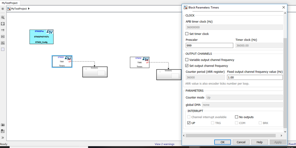

    BMOHA.7
    Visitor II
    December 25, 2018
    Hi0690X000006Cv6xQAC.png,
    Although I used the right configuration, i have the same issue with TIM1 & TIM6 (refer to the attached figure). Did you find a solution ?
    Best regards
    OOleg
    January 24, 2019
    Hi to all!
    Solve problem with the timer endless loop.
    The solution is to setting the timer parameter "Counter Period ..." to 1 or higher when making the setup in STM32CubeMx.
    Otherwise code just stuck in "if (remainAutoReloadTimerLoopVal_S == 0) {" line.
    Best regards,
    Siegurd.
