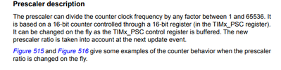

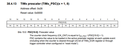

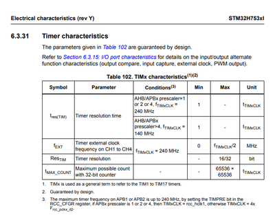

If I want to the timer to run for 10s, having the system clock running at 240Hz. What value should I choose for the prescaler and counter period settings. I want to know the process to calculate the above values?
Imen.D
Hello @hvs_learn ,
Please follow this wiki page to help you on TIimer Configuration and calculate the values: Getting started with TIM - stm32mcu
You can also check the description of timer in the Reference Manual RM0433
Thanks
Imen
