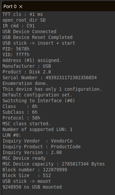

ok, so via swd + DWT counter ->
about 9,2 ms from inserted to fatfs mounted ok;
is 64 GB (noname chinese..) USB stick, exfat , 50GB free.
btw
How often you call the  MX_USB_HOST_Process(); ?
I call it in main loop about every some 5us ....nothing else to do now, waiting for first command.
So this might be maximum speed, that can be achieved .

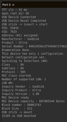

Just for fun - had the idea, to try an old SanDisk 32GB stick, fat32,  also, got ->
about 15ms insert to mounted. Ok for this piece of plastic shi.t , i think.

@Nico3 Trace:
- where the host reads various device (the USB stick) descriptors and strings
- where the host decides that the MCS device is fully detected and starts sending class-specific requests
- where the host successfully receives data from MSC device
- where errors and timeouts  are detected in the above steps, and the app retries them
btw

Pavel A.
about 9,2 ms
This is what should be.
Time individual MSC class requests to find where it wastes time. The capacity in bytes vs block numbers look suspicious.
