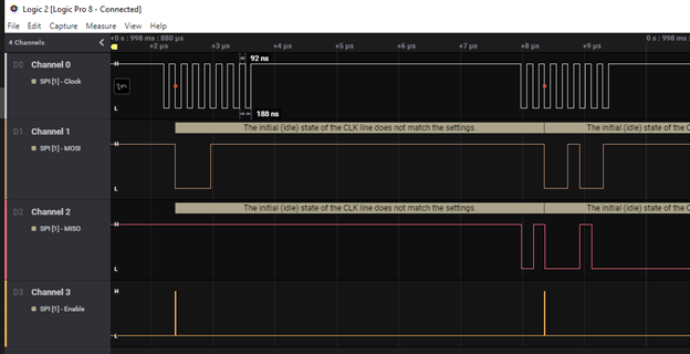

Hello Group,
I am reading SPI from the Nucleo STM#@F401RE with the ST accelerometer LIS2DW12. I set the chip-selected pin low during the transition, but I saw the selected pin go high.
How I fix this problem?
Thanks a lot for your time,
Jack
void readId()
      uint8_t bufp[1];
      uint8_t reg = LIS2DW12_WHO_AM_I;
      reg |= 0x80;
      HAL_GPIO_WritePin(CS_up_GPIO_Port, CS_up_Pin, GPIO_PIN_RESET);
      HAL_SPI_Transmit(&hspi2, &reg, 1, 1000);
      HAL_SPI_Receive(&hspi2, bufp, 1, 1000);
      HAL_GPIO_WritePin(CS_up_GPIO_Port, CS_up_Pin, GPIO_PIN_SET);

Is CS_up configured as a GPIO output pin?
Break it down to where you can toggle the pin successfully, then add in the SPI transfer.

Yes, set the chip-selected pin as GPIO output and control it.
During the transition, I set it low, but I see a glitch that goes high. So what is the problem causes this.
Thanks,
Jack
June 15, 2021
Nothing wrong with the code that you've shown. Either you're monitoring the wrong pin, or it's not set up correctly, or something else is controlling it.
waclawek.jan
June 15, 2021
I don't quite understand the Cube gibberish, but maybe you want to use HAL_SPI_TransmitReceive() instead of those two separate functions.

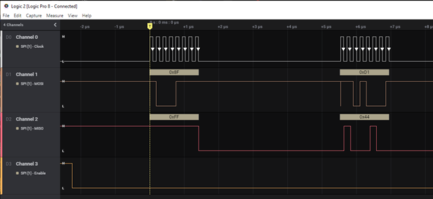

Hello Group,
I found my problem.
My logic analyzer ground connection is loose and that causes this problem.
I put here the correct result.
Thanks,
Jack
