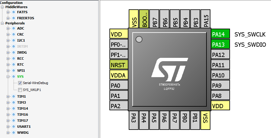

i made my stm32f030k6t6 board and i connect it to stlink
after that  i generate keil V5 project using stmcube .
i  enabled the SWD pins only , after that i compiled the program and download it ,i start the debugger ,but when the program execute the [HAL_RCC_OscConfig()] the debugger send message that it cant communicate with core and every thing stop working ??
#swd #stm32

Maybe you can provide the generated code where it crashes, and information about the external clocks on your board?
You'll want to look to see if there is anything that would alter the SWD pins, or put the device into a low power mode.

With CubeMX generated code, pins are set to there default status if not configured with the tool.
To be able to debug the STM32F1 device in SWD mode, you have to select ''Serial-Wire'' in SYS configuration (Pinout wizard).

He states he has an F0 device

I guess that your custom board has a different clock scheme (no quartz ?), so the software running on the eval board has no chance to run until customized as well.

first i use [HSI] with default trim ,
then i passed it to PLL with (x12) PLLmul  to achieve 48MHZ (max clock speed )
i traced the code and i found that the stlink lose connection with target gust after enable pll using  [__HAL_RCC_PLL_ENABLE();]
if i reduce the PLLmul less than (x6) it run fine
i also test Ulink 2 and the same result
@Mayla
i did what you mention  in stmcube
