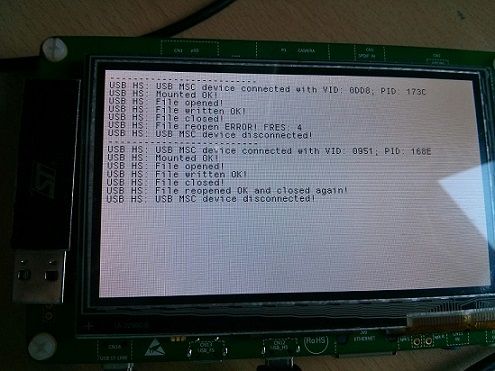

Then, I tried with another USB flash key, and there is funny thing:
1. Mounted is OK (f_mount returns FR_OK)
2. File is opened OK (FA_OPEN_ALWAYS | FA_WRITE | FA_READ)
3. f_puts said that characters are written to file.
4. File is closed OK (At least should be)
5. On some USB FLASH KEY, FR_NOFILE is returned when trying to reopen (With opening mode FA_READ | FA_WRITE) file and there is actually no file on USB, no matter what they returned on f_open and f_puts.
   On some works OK.
All USB flash keys were all formatted in different configurations (But all of them always the same when testing) for testing and write was OK always on the same.
So, I checked again ST example for MSC HOST, trying there the same KEY which didn't work on my example and there it worked OK.

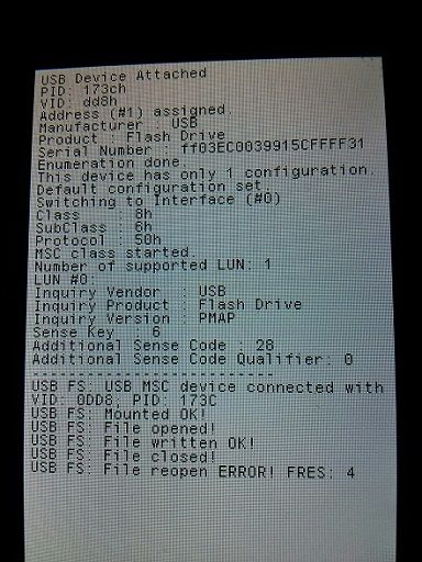

Below is image from my LOG on LCD I made by myself.

Edit: I've enabled FS mode also and I got the same behaviour. First it says that file is opened when I open it using FA_OPEN_ALWAYS mode and that string is written, but file is not on USB.

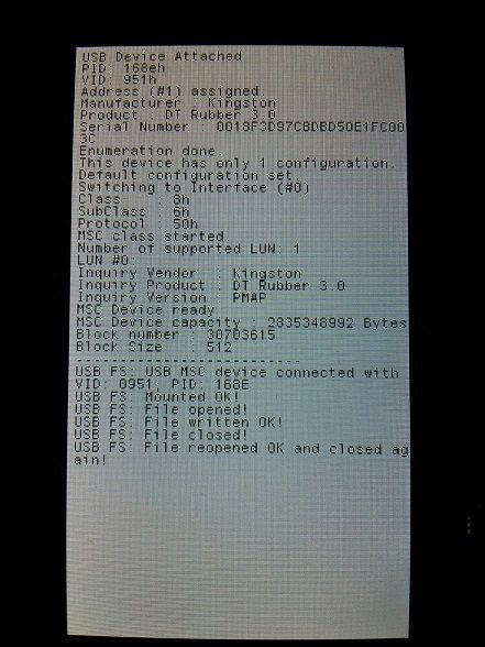

So, I moved forward with research, With USB debug enabled, I found that on devices where file ''is created'' but actually does not exists, HOST MSC stack fails with getting capacity.
Check bottom images, on one it works OK, second does not work.
I'm waiting for your responses ST developers. And BTW..this USB key which does not work here, works on official example without problems, so I must fail somewhere but don't know where should I look. Everything looks the same as in example.
Looking at code, I found that function USBH_MSC_SCSI_ReadCapacity called from USBH_MSC_Process fails with reading capacity. It returns USBH_FAIL and then state machine goes to MSC_REQUEST_SENSE mode which is displayed on LCD for FLASH KE which does not work (''Sense Key 6''). Why is this happening?
Googling about Sense key 6 and sub codes, gives me this:
6 28 00 Unit Attention - not-ready to ready transition (format complete)

Hi, i had the same error.
The problem is in the last revision of the CubeMX library for F4 and think is the same for F7.
At this moment i find a workaround.
I have copied the file ''usbh_msc.c'' from library F4 V1.6.0 to the library F4 V1.7.0, and this is fine.
I think you can copy this file from F4 library in to the F7 library and try.
