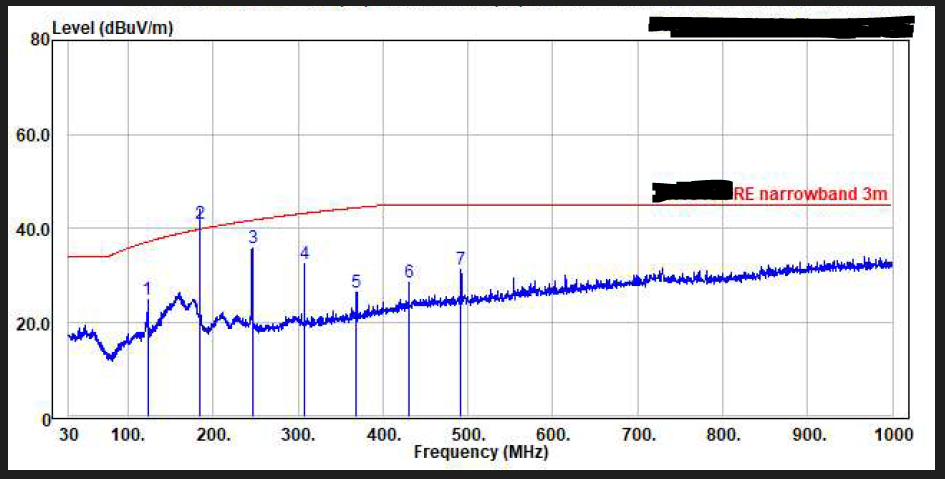

1. Far-field EMI, as shown in the figure below

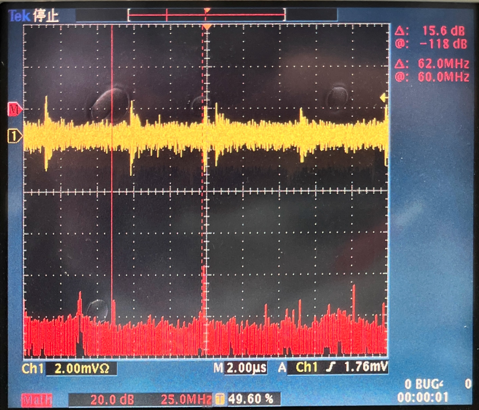

0693W00000WJak6QAD.png2. MCU Near-field FFT, as shown in the figure below(EVM also has this situation)

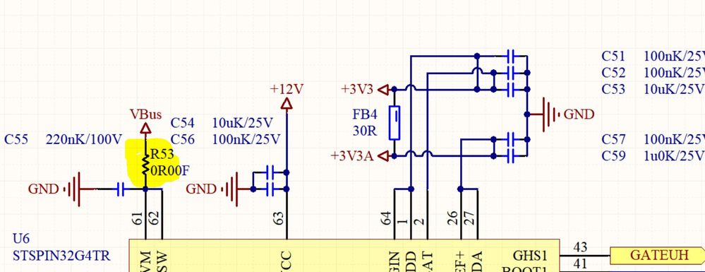

0693W00000WJajNQAT.png3. External power connection, as shown in the figure below
0693W00000WJaj3QAD.jpg4. Use a scope carbon rod and use a ground spring. It is measured that all output signals of the Gate driver have a main frequency of 60Mhz.
5. After I removed the R53, I found that the MCU near-field FFT 60Mhz disappeared immediately​.

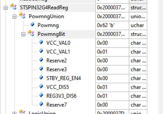

6. Check whether the Buck reg is closed
0693W00000WJal9QAD.jpg7. ​How can I double confirm that the Buck reg has indeed been closed?
    1 reply
