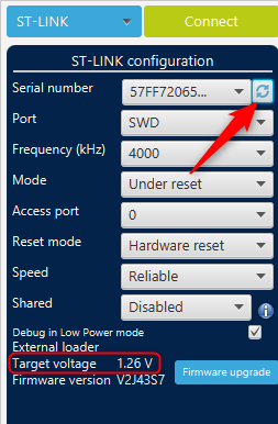

Hello to everyone.
I'm working on a display interface, changing from M3 -> M4 -> H5 CPUs. The issue appeared on all type(it's a HW issue?)
At the beginning I can connect, debug, program and so on. Bt after some operation, I can't continue. I still have a "No STM target found" error, from CubeIDE and Programmer.
What I can see is that the CPU voltage is not 3.3V, but less:
This happen with different STLINK-V2 or V3. Obviously I check the volts on SWD pin 1 and it's always ~3.3V

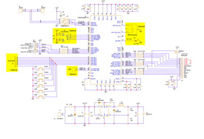

When this happen I usually pas to another board/JTAG. But afer a while I connect the old JTAG-Board and it work again. I enclose the schematics, because I presume it's a HW problem.
Can someone gimme a tip?
Thanks.
Best answer by TheRaprus
You're right!
But after posting my colleague realize that a cable isn't well inserted. It's a mistake, after 2-3 month of tests.
And I'm sure I can't realize it until I made this post :frowning_face:
