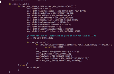

Hi all,
I am using an stm32wb55 neucleo board for a wearable based project. I am using ADC1-IN1 to read the adc raw value from MCU pin PC0 of wb55 board.  A voltage divider circuit was connected to scale down the BAT voltage from (4.2-3.7) to (1.8-1.585).
Vref  = 3.3v.
Below are readings i got
BAT         ADC_BATT      read_raw
0               0                     1420 ( Expected = 0 )
3.7            1.577               2030 ( Expected = 1960 )
4.2            1.8                   2120 ( Expected = 2230 )
Is there any way to rectify this?

1. did you run adc calibration ?
2. impedance of divider high? use long sampling time for adc.
3. connect 100nF on adc-in to gnd .
October 25, 2023
1. Yes, Calibration is done.
2. Yes, 100k and 75k resistors in dividor network.
     sampling time : ADC_SAMPLETIME_12CYCLES_5
3. There are decoupling capacitors mounted to Vref+ pin.
AScha.3
October 25, 2023
so try sampletime 160 cyc.
