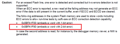

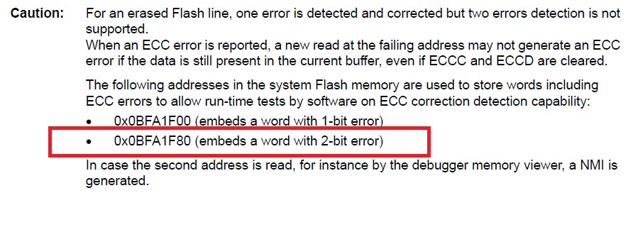

Hi ,
I am working on to implement functionality to detect flash 2 bit ECC error. To test my implementation followed below method in STM32U5 reference manual. With this method,  I am able to generate flash 2 bit ECC error.
However I have following observations
  •  SYS_ECC  bit in FLASH_ECCR register sets upon NMI generation and never clears
  •  2 NMI interrupts generated instead of 1.
Is this is expected behavior. Please clarify.
You leave the NMI Handler? Without clearing the source?
August 7, 2024
Thanks for the quick response. In my case source of the NMI is 2-bit Flash ECC error. Hence I cleared corresponding
flag (ECCD) by writing to 1 bit ECCD in register FLASH_ECCR.
