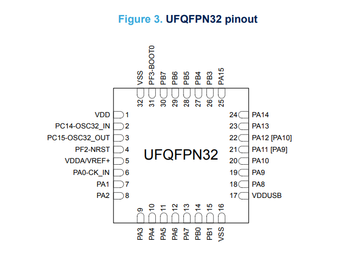

Hello! I am working with a STM32U073 on 1.8V and I want to use the USB feature. Indeed, the datasheet tells us that USB needs a separate power supply around 3V (4.1 Power supplies), but every time when I apply this voltage on VDDUSB pin, it goes to the VDD pins too. And vice versa, if I supply only the VDD pins with 1.8V, same voltage is on VDDUSB, without traces between them. I set / cleared according to datasheet the PVM1, PVMO1 and USV bits (4.2.3 Peripheral Voltage Monitoring (PVM)). It can be something internal? I checked the PCB and traces and is nothing wrong.

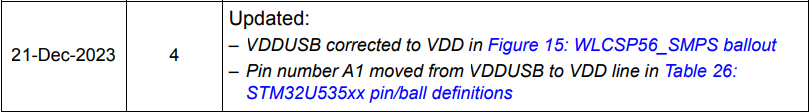

(VDDUSB and VDD pads of the uC) and they are connected. I use a STM32U073KCU6 with UFQFPN32 footprint and in the datasheet (pinout) says that VDDUSB can be independent, but maybe the datasheet needs an update like STM32U535 WLCSP56 footprint: 21-Dec-2023 VDDUSB corrected to VDD.

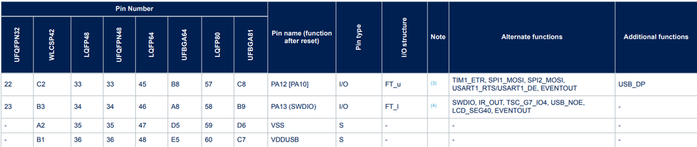

I think I found the problem. In the pinout figure, VDDUSB is present, but in the table below says that UFQFPN32 package does not have a VDDUSB pin and probably is internally connected to VDD and so if I want to use USB with this STM32 I must supply a voltage above 3.0V. Correct me if I am wrong.footprint.png
Your analysis is correct.

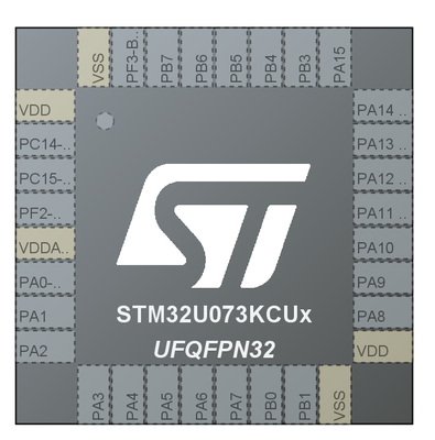

FWIW, CubeMX shows the correct pinout. Bummer the datasheet is misleading.

Indeed the correct information is in the pinout table where pin 17 is a VDD and the UFQFPN32 pinout figure should be fixed.
It is reported internally, thanks for bringing the issue to our attention.

I confirm there is no dedicated VDDUSB on QFN32 package. Request for update of the drawing in DS has been already created, will be done with next planned revision of the document. Pinout table is correct.
Thank you to report this point and sorry for the difficulties.
