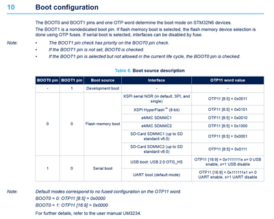

Hey thanks for the response, I could remove it and put it on another board, but then I'd need to make another board which would be more time consuming than just tweaking the one I have and getting another one manufactured. Someone else had this same issue and they solved it by drilling through the other side of the board, which I don't have the equipment for sadly.
For reference here is what the app note says about boot modes, the following section on debugging also doesn't mention it :\
Please update your documentation ST!
