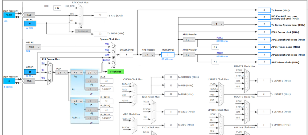

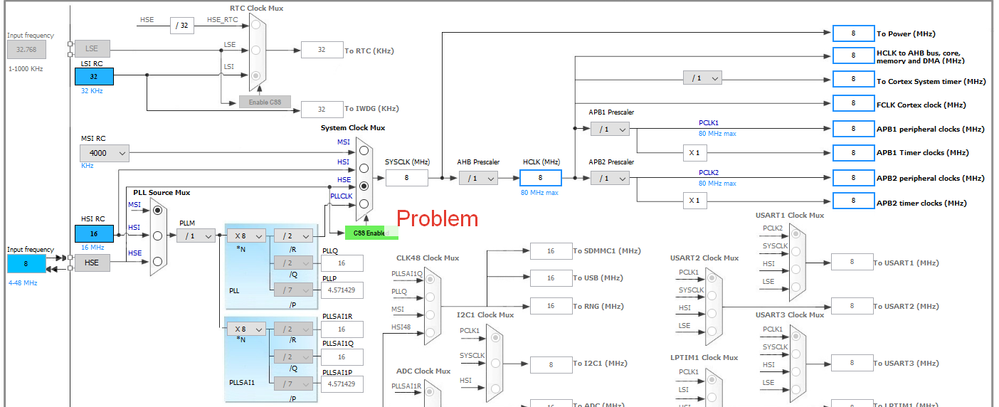

Hello, Help me please. I configuration STM32L452RET6 in the CUBEMX, how on the pictures. Then I build project in the Attolic and go to debuger and then when MCU is starting work, it go in the HardFault_Handler(void) through 1-5 seconds. Why? I can't find problem. Maybe anyone know?
Crystal clock is Abracon LLC ABM9- 8.000MHZ-10-D-1U-T.

Perhaps your Flash settings (wait states) are not correct ?
I would try with a reduced core clock.

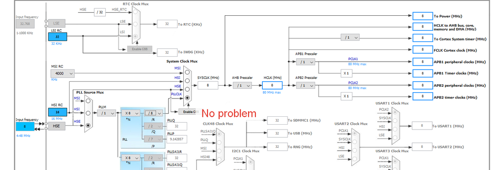

If I connect System Clock Mux to PLLCLK, no problem. But if connecting to HSE, problem is save.
Posted on July 10, 2018 at 17:38
If you are clocking at 8 MHz I don't think the flash is an issue.
Device should start/run from 4 MHz MSI
You might want to enable HSE and feed to MCO (PA8) pin, and scope it there.
For oscillator source, consider HSE BYPASS mode.
Check HSE coming ready.
Check also define for HSE_VALUE in stm32xxxx_hal_conf.h
There have been issues with PLLM value being set up properly, but again, should drive directly from HSE
